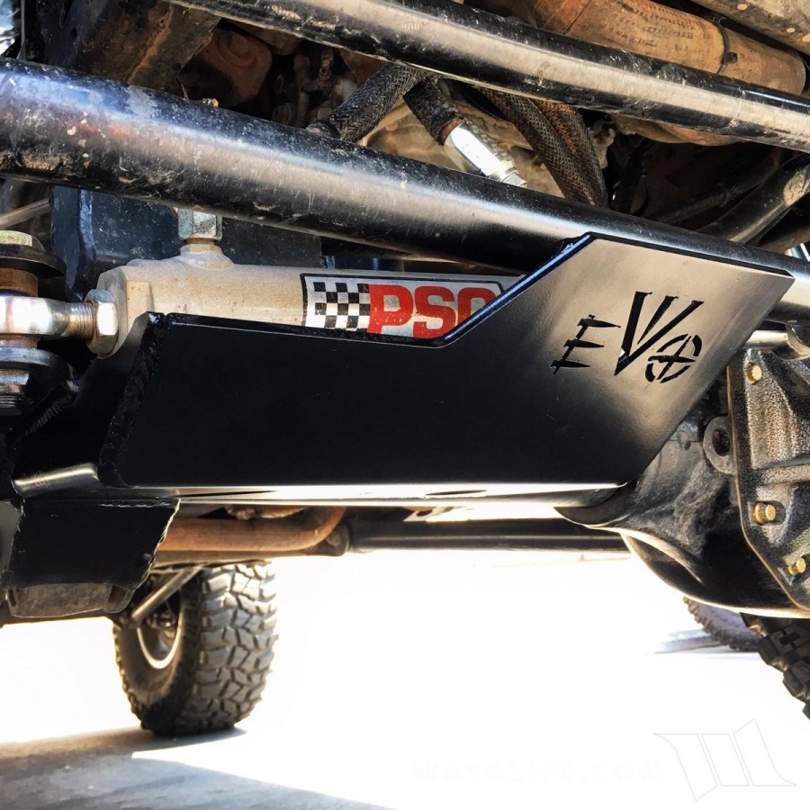

Finally got around to visiting our good friends Mel and Lisa down at EVO and to get a ram assist skid installed on Rubicat.
All racked up and ready to armor up the ram.
Mel sizing things up and double checking the all new skid made specifically for the XD60.
Time to burn things on!
Ta-Da! What the EVO ram skid looks like installed on our Dynatrac XD60 :cool:
:cool:
aTX427
Eddie, slightly off topic, but in your write up, you have some great pictures of your PSC cylinder. It looks like the mounting collar is about 45* angled down towards the rear. Is that correct? Also, did the Evo cylinder guard require a lot of grinding to fit?
No, that is not correct. Yes, it was pointing down a bit at first but part of that was because of the position of the tie-rod. I have since rotated it so that it is always angled upward. EVO did the install of the skid and it pretty much welded right up.
aTX427
If you have a chance, I would appreciate seeing how you have it now. I'm in the process of installing mine.
aTX427
I called Evo about the XD60 hydraulic cylinder guard was it designed for the PR60, not the XD60. Was yours a one off
