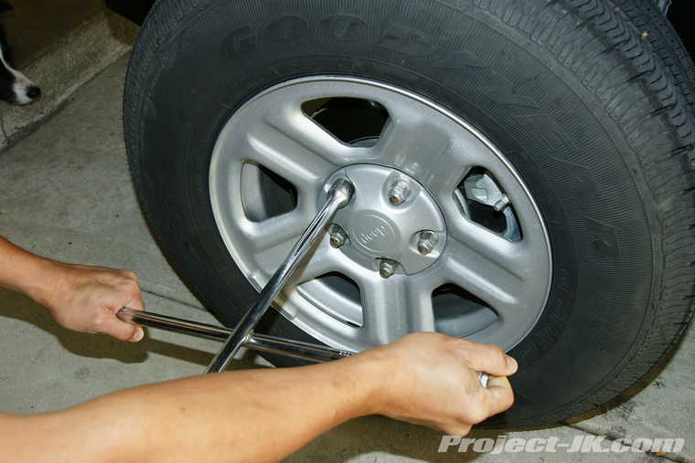

    1. Loosen but do not remove the lug nuts on your Jeep JK Wrangler’s front wheels using a 19mm socket or lug wrench. Then, using a floor jack, raise the wheel you will be working on from the axle until it is off the ground and remove it.

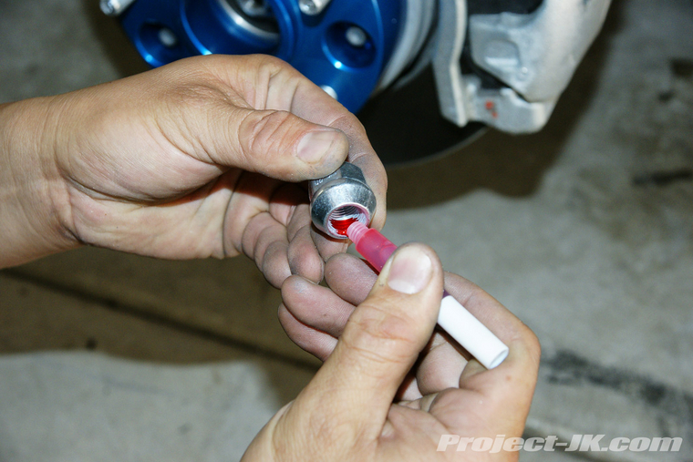

    5. Apply a dab of red loc-tite to the inside threads on each of the 5 lug nuts that you will be using for the installation of your Spidertrax wheel spacer.

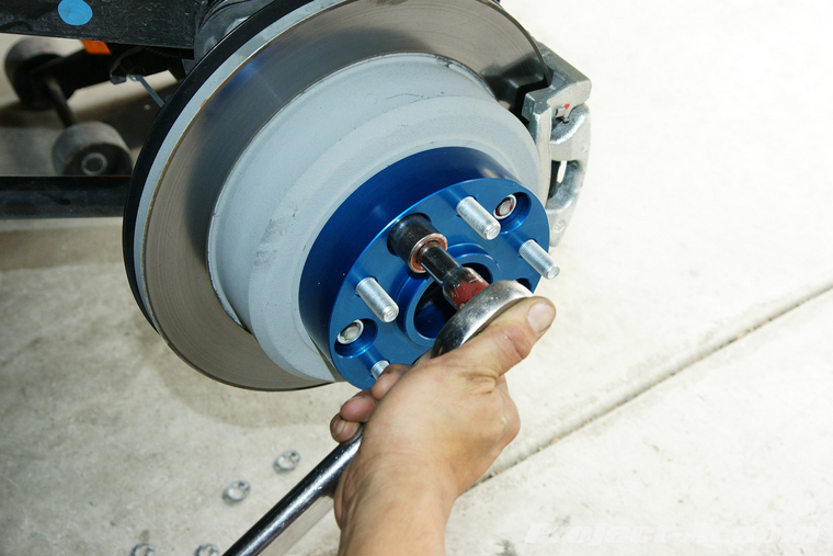

    6. Making sure that the tappered end of the lug nuts are pointing towards the countersunk holes, secure your Spidertrax wheel spacer in place using a 19mm socket and making sure to slowly tighten the nuts in a 5 point star pattern.
    7. If you have a friend handy, you can have them step on the brakes to keep the axle from spinning. Or, if you don’t have help handy, slide a long flat head screwdriver through the top of you rotor to hold it in place as shown in this pic. Then, using a 19mm socket, tighten all 5 lug nuts in a star pattern to 95 ft. lbs. of torque.

    9. Installing Spidertrax wheel spacers on your rear axle is done pretty much the same way only easier. For one, you can raise up your axle from the differential effectively lifting both wheels at the same time and, you can put your transmission in gear and apply your hand brake to keep the axle from spinning.

    Another question I have is about the red lock tight. That stuff is like super glue. Will someone ever need to take the spacers out? I swear by the blue lock tight for screws and bolts that I may need to remove at sometime but I've had a few bad experiences with the red when it came to removing parts I used the red lock tight on... just curious how hard it would be to remove them if you needed to?
    I know you sure don't want those lug nuts to back off at all!
    The trick to red loc-tite is not apply too much. You really just need a drop for most applications. Being that we're working with 1/2" studs, I can assure you that you will not have an issue with removing the nuts at a later date so long as you don't go crazy with the loc-tite. Trust me, I've run spacers on most of my Jeeps and have never had an issue.
