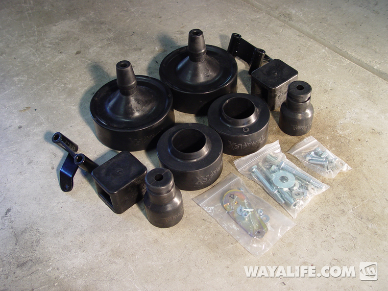

    What You Will Need to Get
    (2) 2.5″ Front Coil Spacers
    (2) 2.5″ Rear Coil Spacers
    (2) Front Bump Stop Extensions
    (2) Rear Bump Stop Extensions
    (1) Complete Set of Shock Extensions or New Longer Shocks
    (2) Rear Brakeline Extension Brackets
    (2) Rear Sway Bar Links
    Optional Components You May Want
    • Adjustable Front Track Bar
    • Rear Track Bar Relocation Bracket
    • Adjustable Front Lower Control Arms
    None of the above is required but, the adjustable front track bar and rear relocation bracket will help you to recenter your axles. Some people may experience a flighty sensation when driving at highway speeds after installing a small lift and adjustable front lower control arms will help you to add back some positive caster and that will help things out.
    This is a pic of all the parts you whould get with something like a TeraFlex 2.5″ Budget Boost with shock extensions. Newer kits come with new rear sway bar links and rear brakeline extension brackets (not shown in the photo below). There are other kits similar to this and so long as you have all the components listed, you'll be in good shape.

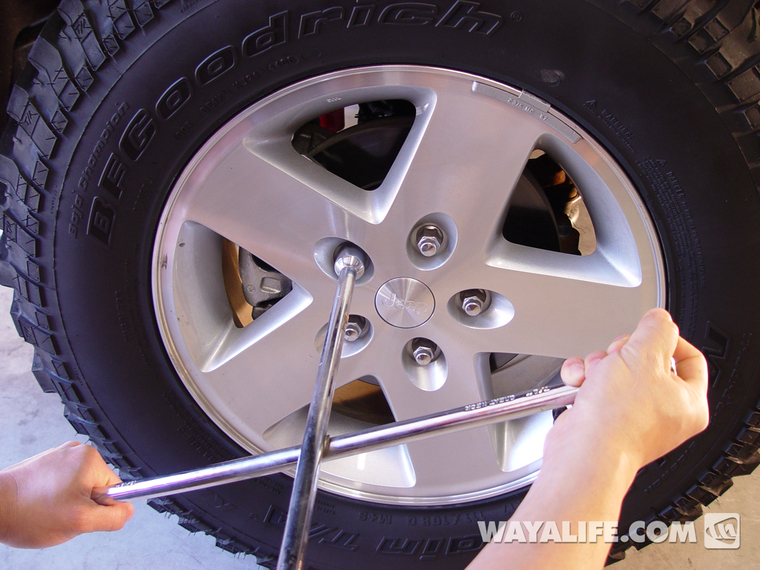

    1. Park your Jeep on a level surface and crack the lug nuts on your front wheels loose. If you have an automatic transmission, use an 18mm socket to remove the 3 bolts (one on each frame rail and one on the cross member) securing its skid plate to the frame. Remove the skid plate and set it aside for now.
    2. Chock your rear tires, loosen (but do not remove) the lug nuts on your front wheels, raise the front end of it one side at a time from the axle using a tall floor jack and then lower it back down onto (2) jack stands, each placed just behind the lower control arm frame mounts.
    3. Remove the front wheels using a 19mm lug wrench or socket and set them out of the way for now. Leave the floor jack under the front axle to help support it.

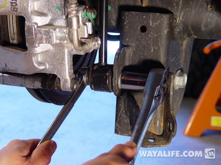

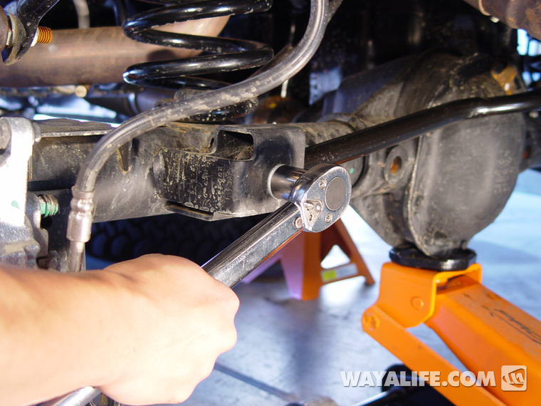

    4.Using an 18mm socket and wrench, remove the bolts and nuts securing the front sway bar links to the lower axle mounts.
    5. Slip a 19mm wrench in between the sway bar link and sway bar itself to hold the ball joint stud in place. Then, use an 18mm wrench to remove the outer nut securing it in place. Completely remove the sway bar links discard them.

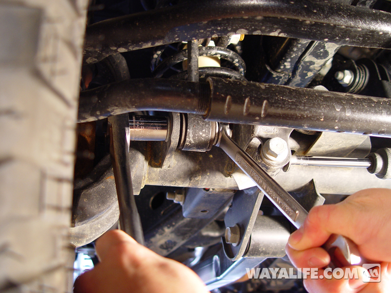

    6. Using a 5/8″ wrench, hold your front shock can in place just below the upper shock mount to keep it from spinning. Then, remove the stud mount nut above using a 16mm wrench.

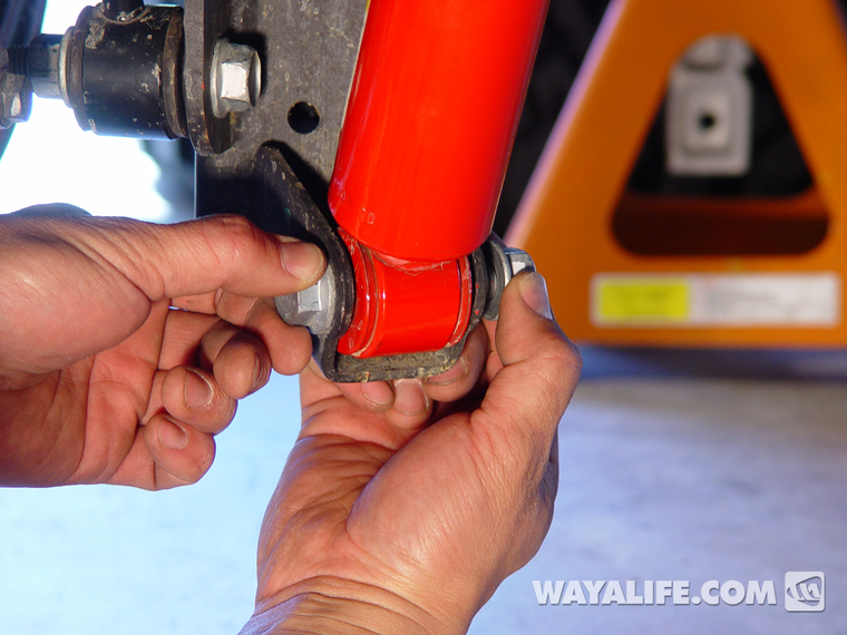

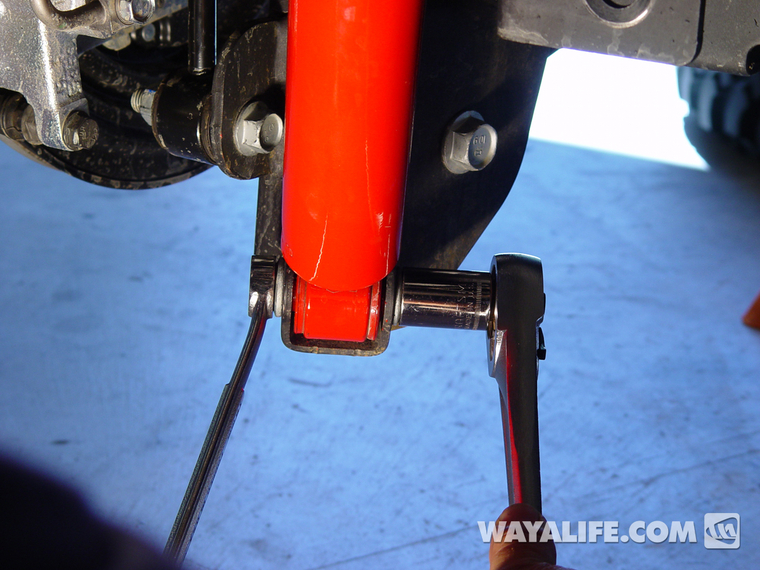

    7. Using an 18mm socket and wrench, remove the bolt and nut securing the front shocks to the lower axle mount.

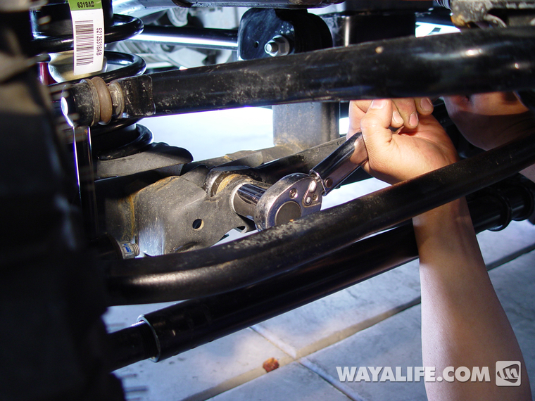

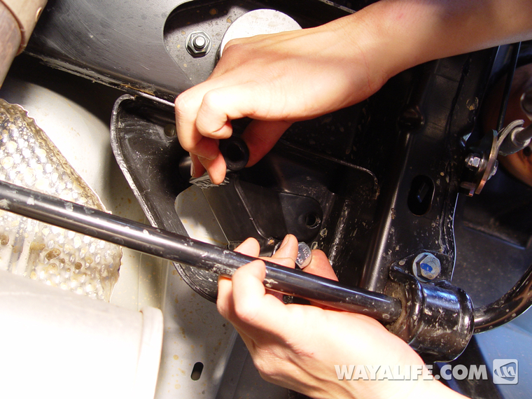

    8. Use a 21mm socket to remove the bolt securing the front track bar to the front axle mount. Loosen but do not remove the frame mount bolt. These can be tough bolts to remove and an impact wrench or breaker bar will help to make this job easier. Once removed, set aside the flagged nut and lower bolt and leave the track bar attached to the frame.
    9. Being mindful of your brake lines, carefully lower your front axle until the factory front coils can be slipped out of the upper perch and be removed completely with ease.

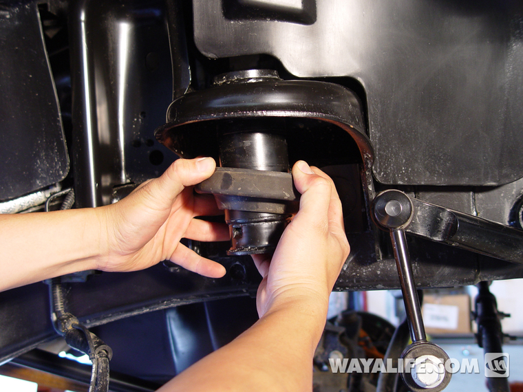

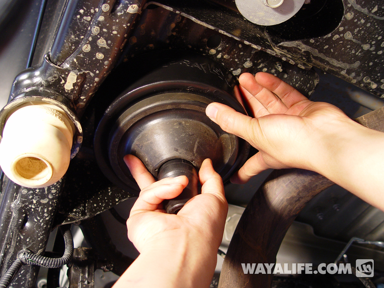

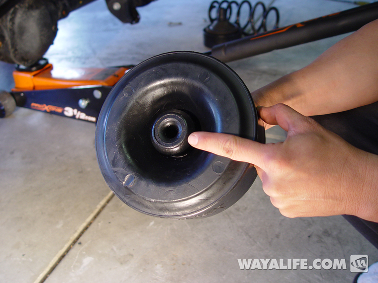

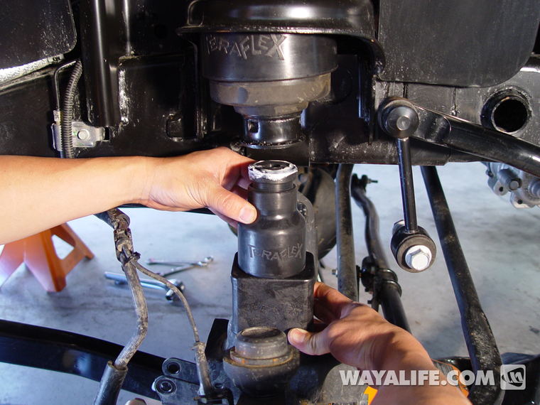

    10. Firmly grab the yellow jounce stop and pry it out of its retaining cup.
    11. Slide the factory rubber coil isolator down and off the upper spring perch.

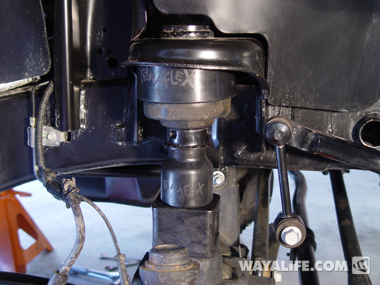

    12. Install your new 2.5″ coil spacers up onto the upper spring perch followed by the factory rubber coil isolator as shown in this photo.

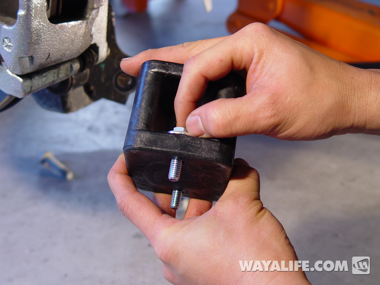

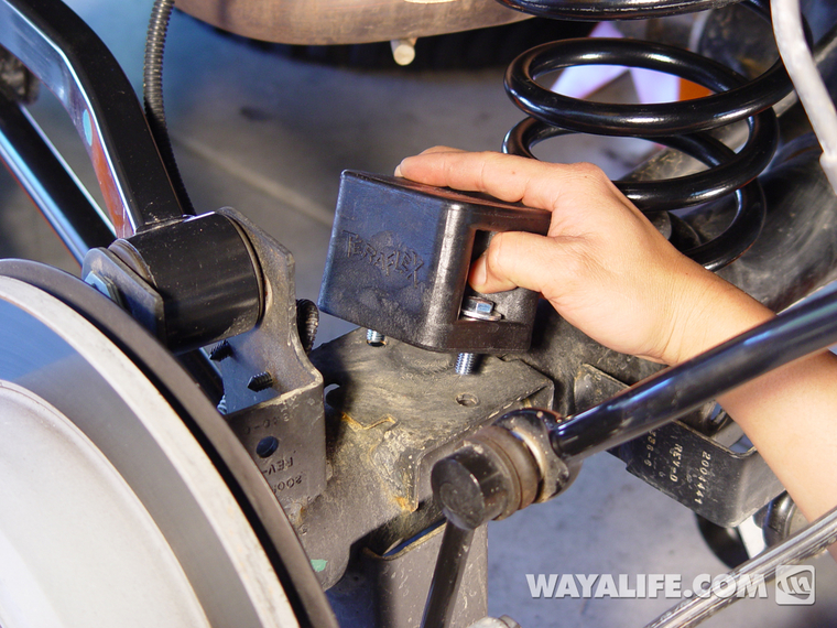

    13. If your kit came with front bump stop extensions that install into the factory jounce stop retaining cup, apply some white lithium grease to the connecting end of it as shown.
    14. Place one of your new rear bump stop extensions on top of the front axle lower spring perch and then position a front bump stop extension on top of it just under the retaining cup.
    15. Using your floor jack, slowly raise your front axle up until the front bump stop extension plugs into the retaining cup.

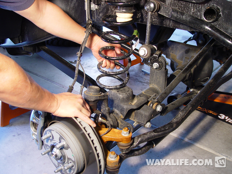

    16. Lower your front axle back down, remove rear bump stop extension sitting on top of the lower spring perch and then install the factory yellow rubber bump stop into the new front bump stop extension.
    17. Install your factory front coils up back onto place making sure that it terminates at the index on the axle spring perch. You may need to push down on your front axle a bit in order to get it in.

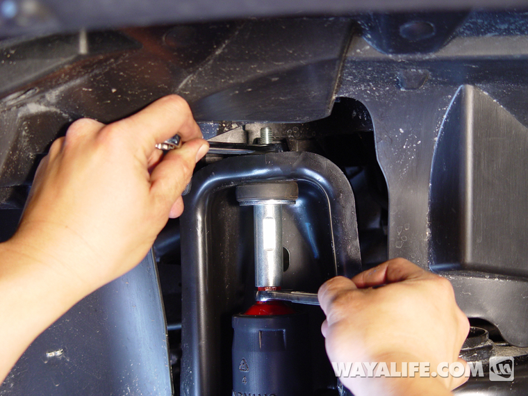

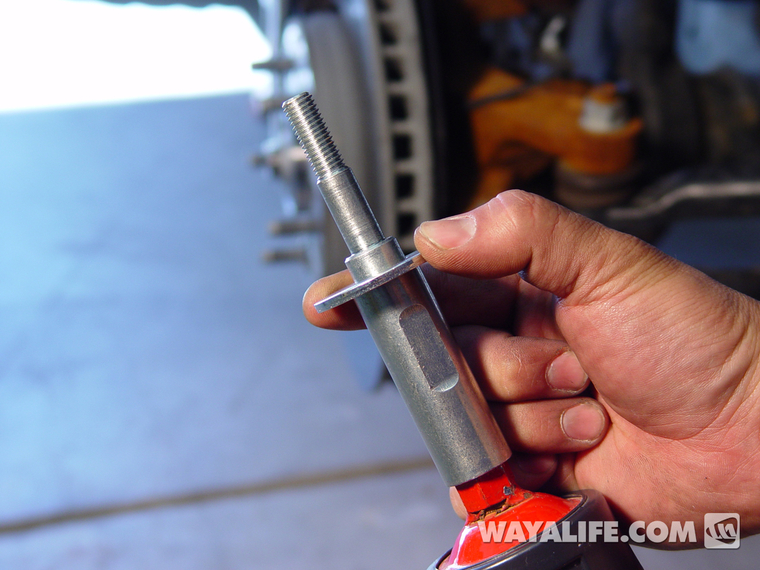

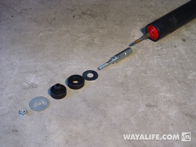

    18. If you purchased your Budget Boost with shock extensions like what TeraFlex makes, layout and assemble the pieces to it as shown in this photo. Please note, you will need to reuse the factory rubber bushings and upper washer.
    19. Using a 13/16″ and 5/8″ wrench, install the shock extension main shaft onto the upper stud mount of your factory front shocks.
    20. Slip on the new large washer that comes with your front shock extensions onto the main shaft. Follow this with the stepped factory rubber bushing.
    21. Slip your front shock with new extensions up into your front upper shock mount, slip on the upper factory rubber bushing on to the mounting stud, place the large factory upper washer on top of it and then secure everything in place using the factory nut. A 16mm and 5/8″ wrench will be needed for this job.
    22. Using an 18mm socket and wrench, secure your front shocks to your axle mount using the factory hardware and tighten the nut and bolt to 56 ft. lbs. of torque.

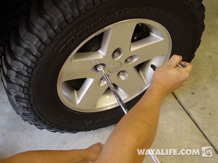

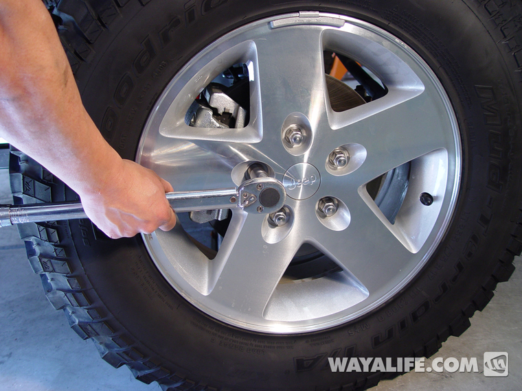

    23. Reinstall your front wheels, lower it back down on the ground, tighten the lug nuts to 95 ft. lbs. of torque, remove the wheel chocks from the rear and place them up front.

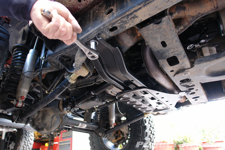

    25. If you have an automatic and removed your skid plate earlier, use an 18mm socket to re-install and secure it to the frame of your Jeep JK Wrangler using the 3 factory bolts.

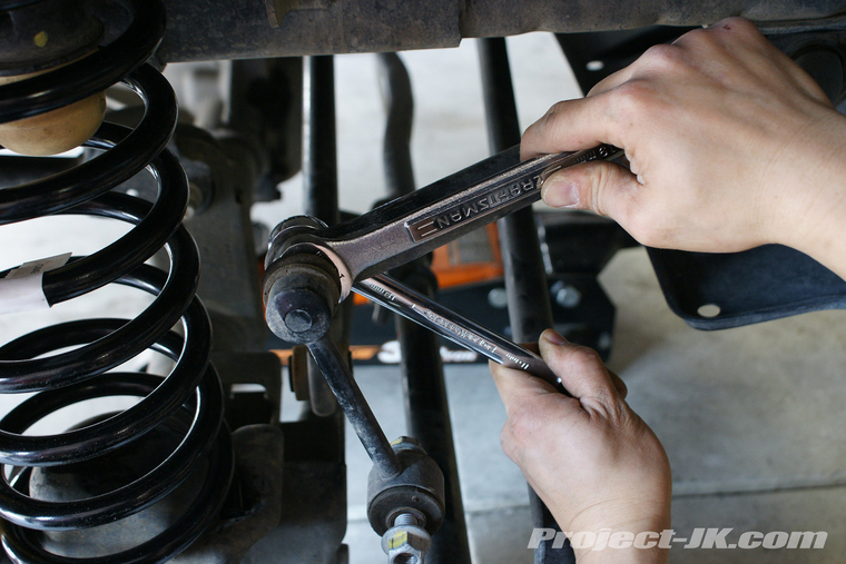

    29. Using an 18mm socket and wrench, remove the bolts and nuts securing your rear sway bar links to the lower axle mounts. Then, slip a 19mm wrench in between the sway bar link and sway bar itself and hold the ball joint stud in place while removing the nut securing it in place with 18mm wrench. Completely remove your links and set them aside for now as they will be reused in place of your factory front links.

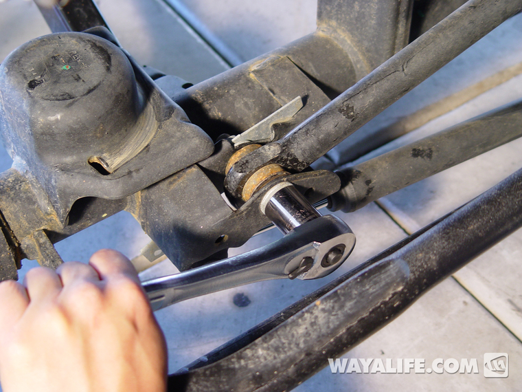

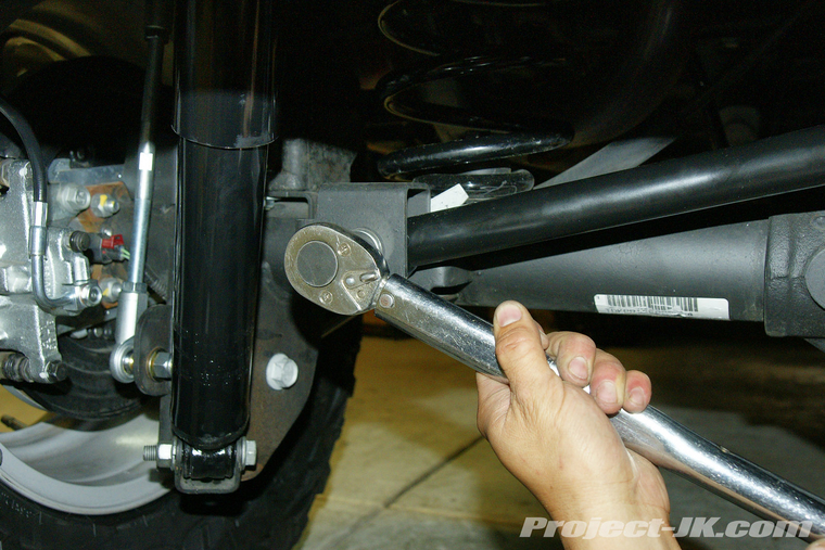

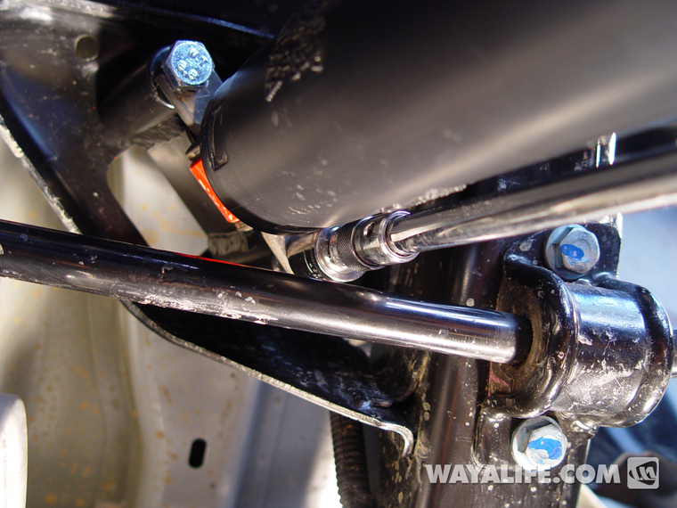

    30. Remove the rear track bar bolt and nut from the lower axle mount using a 21mm socket. Loosen but do not remove the frame mount bolt. As was the case with the front track bar, this can be a tough bolt to remove and a breaker bar will help to make this job easier.

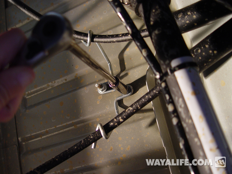

    31. Using a 10mm socket, remove the 2 nuts securing the emergency brake cables to the bottom of the tub. This is necessary in order for you to get your rear axle to droop enough to install your new coils.

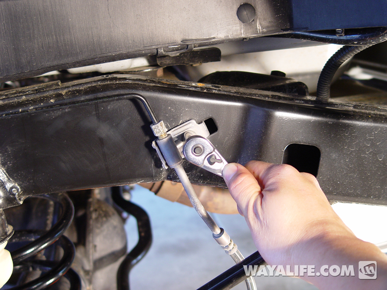

    32. Using a 10mm socket, unbolt the rear brake line brackets which are fastened to the outside frame rails. Leave them dangling at this time.
    33. Slowly lower your rear axle being mindful of the ESP wiring. Once your axle is dropped low enough, your factory coils should just about fall out and can be removed with ease. Set aside the upper rubber isolators as they will be reused.

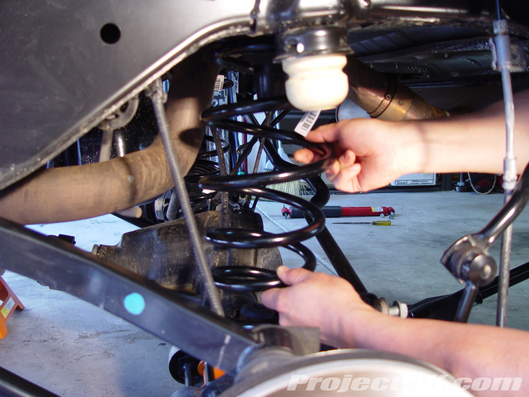

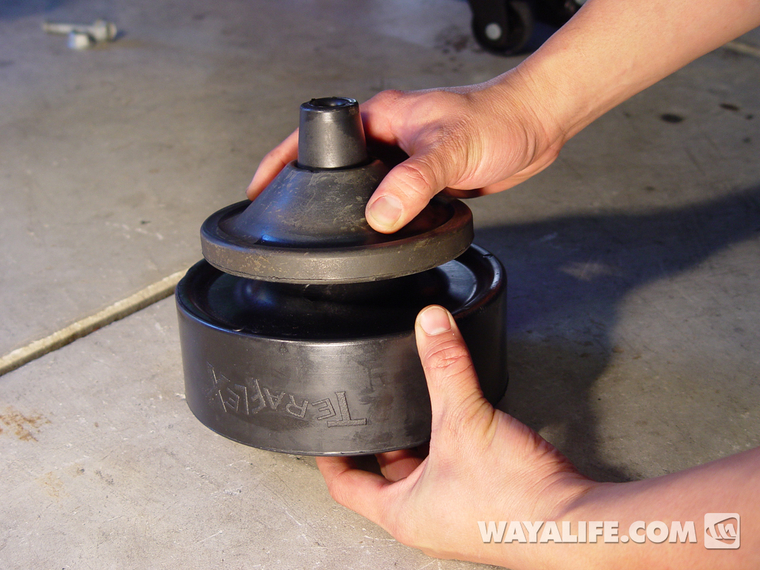

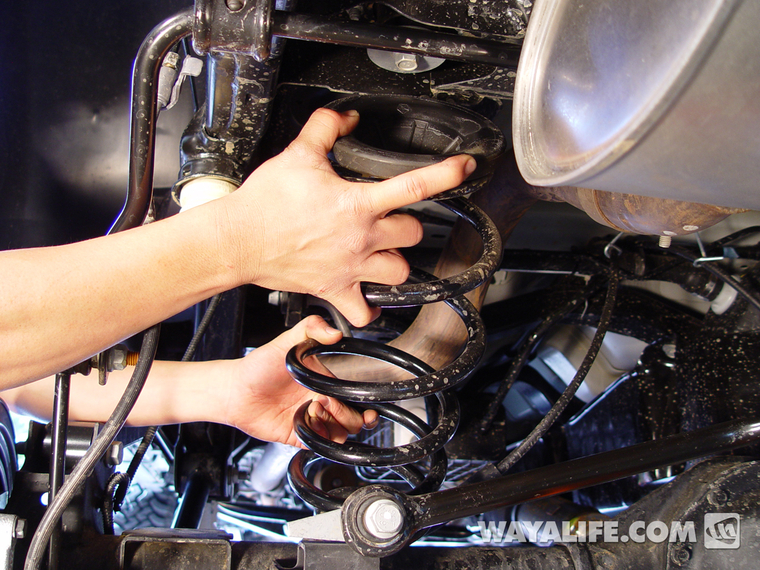

    34. Take your new rear coil spacers and install the factory rear coil rubber isolators onto the center post as shown in this photo.

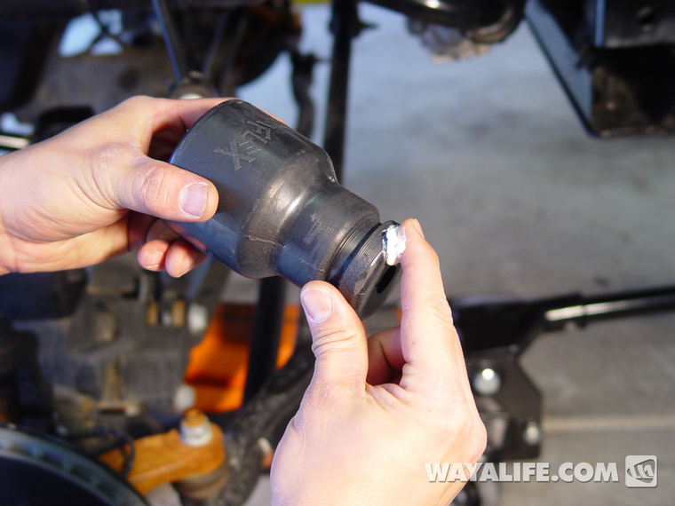

    35. Apply a small amount of white lithium grease to the knob on the upper side of your new rear coil spacers.
    36. Plug your new rear coil spacers up onto the hole of the rear upper spring perch.
    37. Re-install your factory coils underneath your new rear coil spacers making sure that it is properly seated on the rubber isolators.

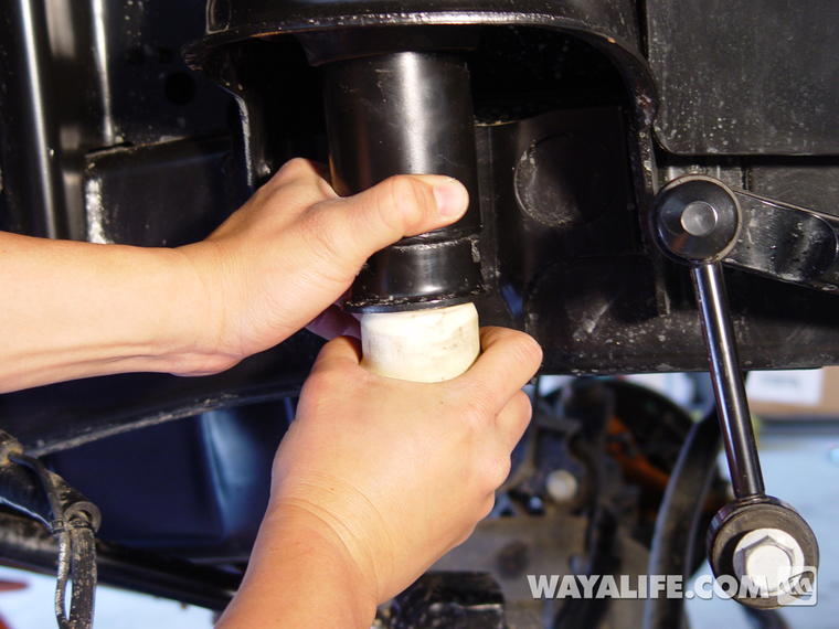

    38. Install 2 of the bolts and washers provided with the kit into the holes on the rear bump stop extension as shown in this photo.

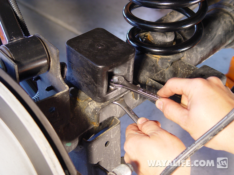

    39. Place the rear bump stop extension on top of the axle bump stop plate making sure that the bolts go through the existing holes. On newer kits, this bump stop will be shaped like a parallagram and have a top that is skewed over to one side from the bottom. Install these with the top surface pointing towards the front of your Jeep.
    40. Using a 1/2″ and 13mm wrench, secure the rear bump stop extension to your axle bump stop plate using the lock nuts and washer provided with the kit.
    41. Using an 18mm socket and wrench, install your new sway bar link onto the lower axle mounts with the factory hardware and tighten them to 75 ft. lbs. of torque. Then, install them to the sway bar using the hardware provided. Once installed, apply some grease to the zerk nipple using a grease gun.

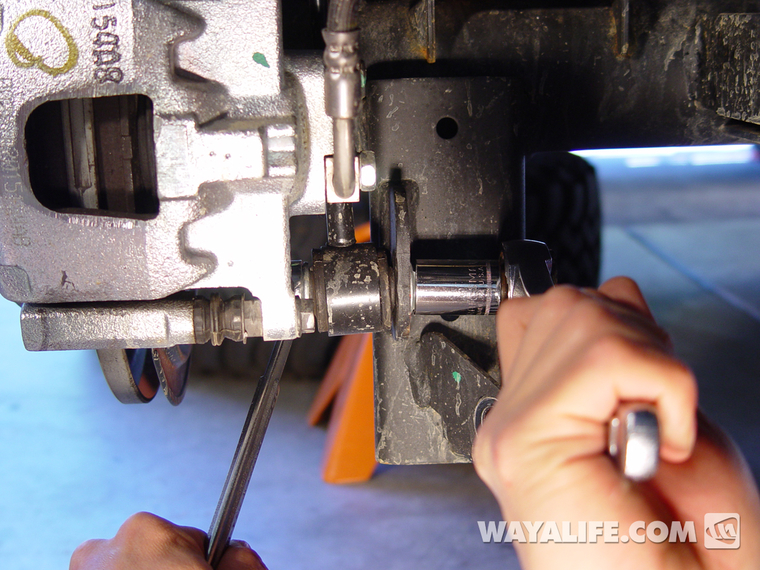

    42. Using a 10mm socket and the factory hardware, install the rear brake line extension brackets onto the frame rails with the bends pointing toward the center of your Jeep and the notches pointing backward.
    43. Secure your rear brake lines to the new extension brackets using the bolts, washers and lock nuts provided with the kit. You will need a 7/16″ socket and wrench for this job.

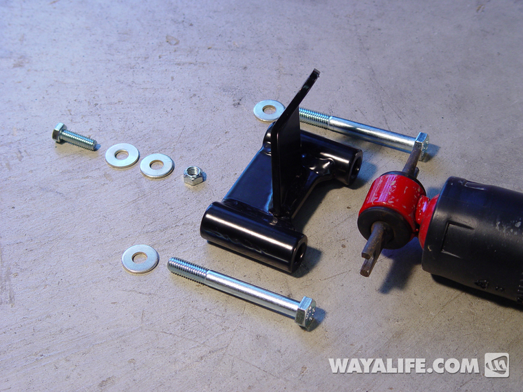

    44. Layout and assemble the pieces for the rear shocks as shown in this photo.

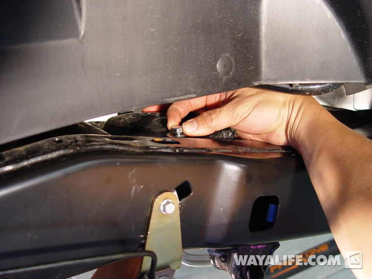

    45. Loosely install the rear shock extension onto the upper frame mounts using just one of the long bolts provided with the kit.
    46. Slip one of the small bolts and washer throug the top of the frame rail and loosely secure the rear shock extension bracket to it from under neath using one of the lock nuts and washers provided with the kit.
    47. Loosely install your rear shocks onto the lower axle mounts using the factory hardware. This will help you hold everything in place while you secure the TeraFlex rear shock extension bracket and upper shock mount in palce.
    48. Using a 17mm socket and 6″-12″ ratchet drive extension, secure your rear shocks and extension brackets to the upper frame mountwith the long bolts and washers provided with the kit. Tighten these bolts to 37 ft. lbs. of torque.
    49. Using a 1/2″ socket, a 6″-12″ ratchet drive extension and a 1/2″ wrench, tighten the additional small bolt and nut securing your new rear shock extension to the upper frame mount.

    52. Reinstall your rear wheels, lower your Jeep back down on the ground, tighten the lug nuts to 95 ft. lbs. of torque.
