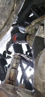

Hey guys, sorry to bump a few months old thread, but I think my Jeep is experiencing this. It's a 2015 with 60k. Could this leak enough to drip oil down to my O2 sensor? Something is dripping on my driver's side and hitting my sensor and causing a code. This is the highest item in the engine that appears to be wet. I have also heard it can be the oil filter housing (still have the original plastic one), but the passenger side of the engine seems dry.
Here's a view up from the O2 sensor:
And I believe this is the camshaft sensor? Definitely wet around it, but hard to get the camera in there.
