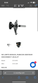

Did you test the disconnect by hand on the bench or on your Jeep to see if it's working properly?
Yeah for sure. Both before I installed the bar and since. I’m sure that when it’s engaged the force I apply with my hand is substantially less than the jeep rolling over even a small curve in the road. I suspect it’s not fully engaging too — but I don’t know how it would sound if it were broken.

Not necessarily. If what you're hearing is a loud clunking or snapping, it could be not engaging. If what you're hearing is just a clicking, I would double check your link connection points as they might be just ever so loose enough to allow for movement. This is NOT uncommon.

I pulled off the knob and reinstalled the actuator for a week in the sand dunes. Bar didn’t click at all and that confirms where the sound was coming from.
I emailed Evo and they came back with a rather short but interesting reply, which is that my particular bar might just need less pressure to work properly and their advice is to cut a loop at a time off the spring until it works correctly!
I’ll have to remove the sway bar to make that kind of process work, I could never get it to pop reliably when driving.
