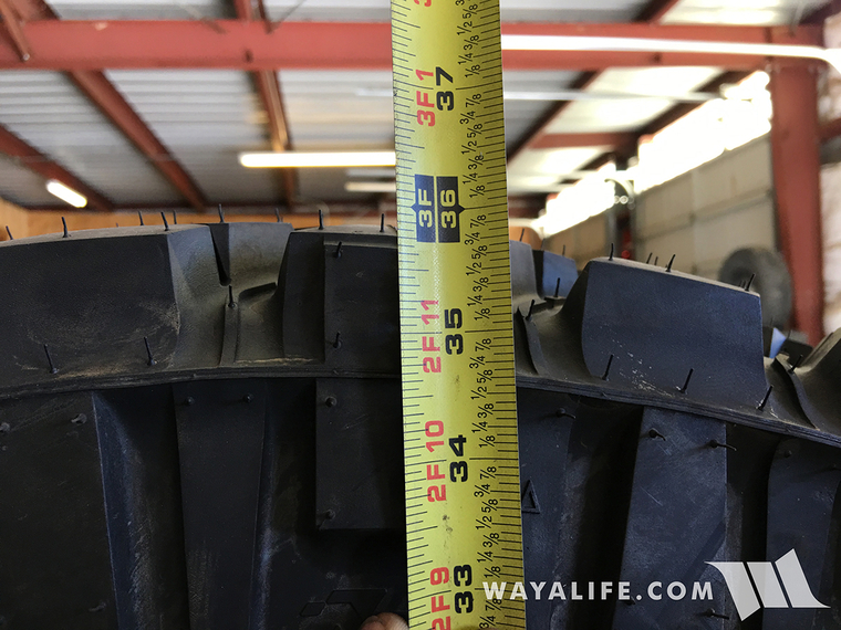

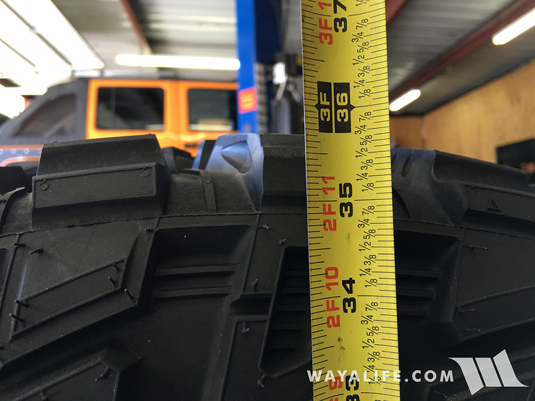

They look great. Did you get a chance to see what the height measures mounted up?
Well, as you know, ALL tires measure smaller than what is stated on the sidewall but un-mounted, I got a measurement to the shoulder that came up to 35-11/16".
As you can see, this is 1/16" less than a brand new Nitto Trail Grappler un-mounted.
Mounted and with the full weight of our Jeep, the Cooper STT Pro came up to 35-1/8".
