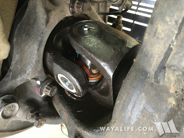

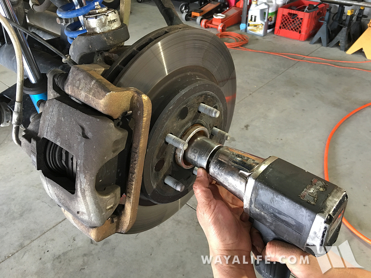

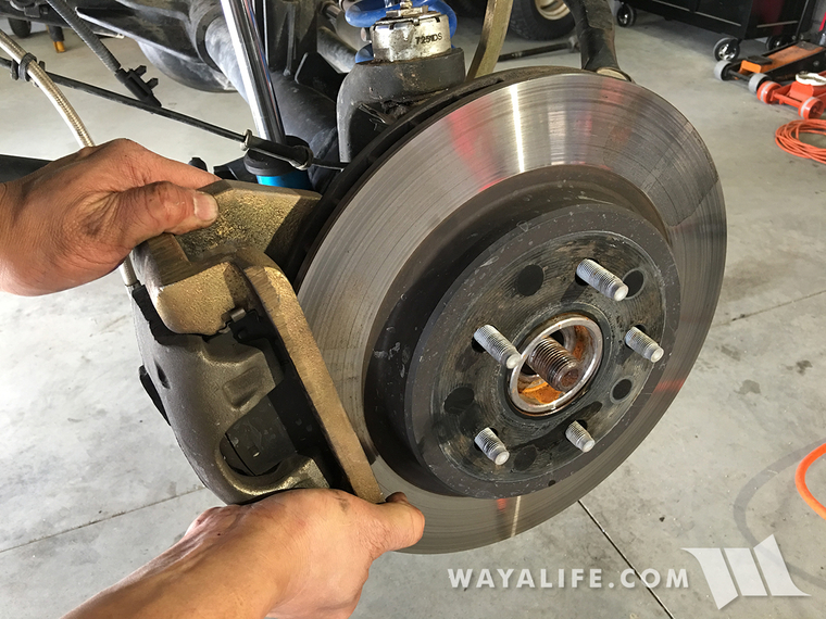

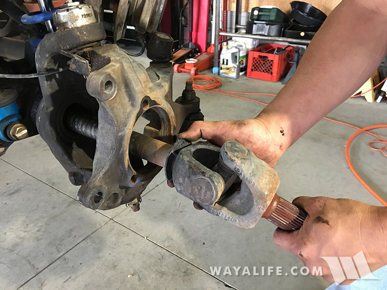

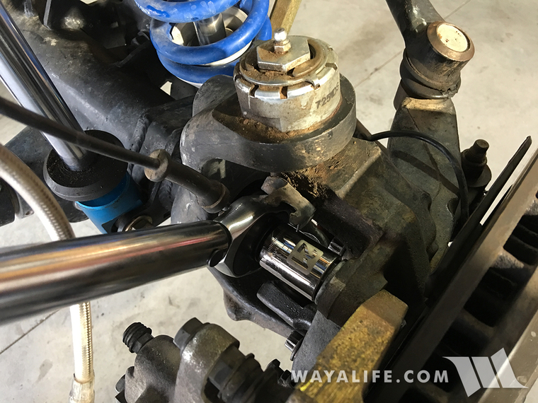

Haven't tried that spot yet, worth a shot. I was having trouble getting it past the end of the hub itself circled here, since I didn't remove it from the shaft:

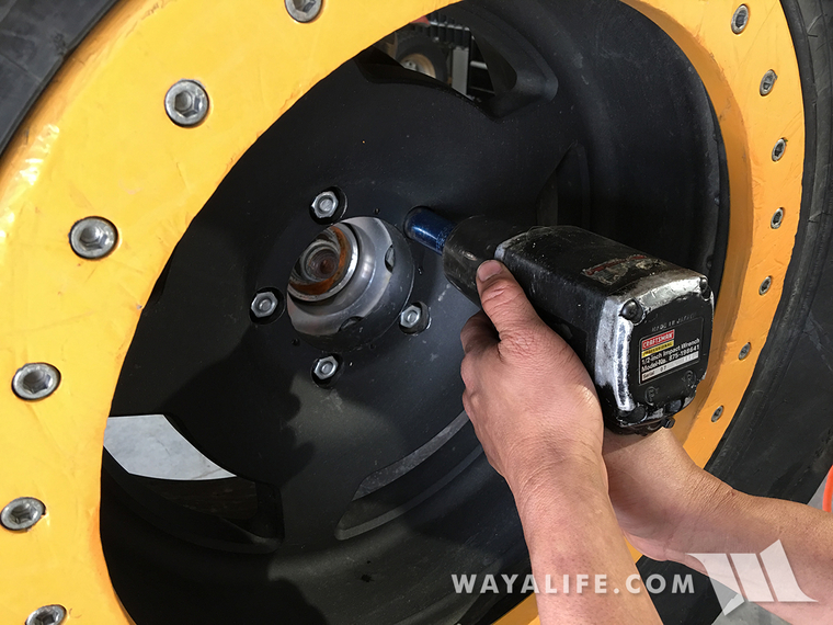

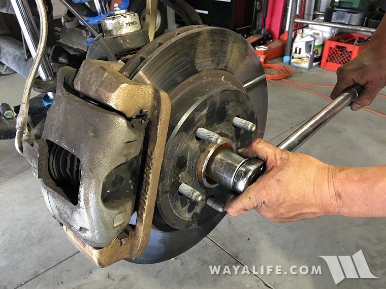

Think it'd help to remove the hub nut? I just didn't have a 36mm on hand and didn't think you'd need to remove it.
Oh ok, sorry, I misread. Didn’t realize you didn’t get the hub off.
Yea definitely gotta take the hub nut off.
Hub nut off, pull wheel bearing, then pull out axle shaft. Unless I’m missing something in your question…
EDIT: Jesus, thinking about it, maybe you wouldn’t have to take the hub nut off…I’ve just always followed that order of operations! And I’m usually replacing a hub so it’s just habit…sorry, no help here
No worries I'll give it a go, I should have giant sockets laying around somewhere. You must've done something right yours were out! Lol
