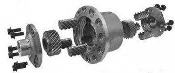

Those clutch plates are what make it an LSD differential and you can usually only buy it as a carrier assy. A Trutrac is not the same nor is it an open differential carrier.
The gear numbering 'up' means a larger #. So yes, '3.73 and up' would take care of 4.56 gears.
A Trutrac is more like this:
Thanks Doug. I always learn something new from everyone here. I've steered away from a lot these items due to fear of messing it up myself.
