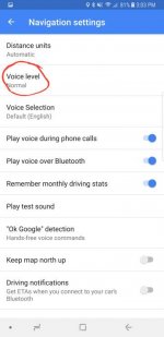

I just purchased a JL about a week ago. Still figuring it out. If I am using google maps on carplay, I can barely hear the voice turn by turn instructions. If the radio is on it is really difficult. The volume on my phone is all the way up. The voice commands sound like they are coming from the vehicle speakers. I recall this on a prior vehicle that had a garmin navigation. On that vehicle there was a way to increase the sound of the navigation voice instuctions. Anyone know how to up the volume for my google maps via carplay?

There's a setting for the voice volume in Google maps settings.

May be the same with CarPlay as Apple, while connected to the radio with Bluetooth I have to turn the phone volume up with the buttons when the map voice is on and speaking, then the next time the map voice is on I turn up the radio volume. After that it stays loud through the radios speakers.

In my pioneer I have an option for nav voice volume, I tinkered with the phone setting and the stereo setting to get the right mix. At first I had to go digging through the menus.
