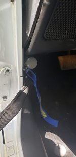

    I just got the Ravelco installed on my 2017 JKU, it kills both the starter & fuel pump. You have to retrain yourself to remember to remove the Ravelco key everytime you leave the Jeep. I hung a long keychain from mine to help remind me.
    FYI: Ravelco offers a 10% AAA Auto Club discount.
