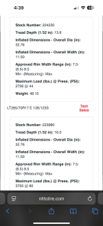

I have a quick question. I’m doing an inch and a half suspension lift (Clayton offroad). I have a steel front bumper and a badlands winch.
I’m wanting to move up to 33s from my stock Nexen HTX2 tires. I’m worried about weight and gear ratio becoming a problem. Is this a valid concern moving up to let’s say KO2s? Do you have a suggestion as to a specific tire? I even see a KO2 35 class c is similar in weight to a KO2 33 Class E. Really just looking to hear what the best option is that prevents me from having to regear. I also would love to stay on stock wheels (I have spacers) until I can save some more up. Thanks.
