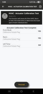

So, blowing only hot air. In all settings. With and without A/C on. There is no clicking or any noise.
I ran a test with JScan and I could hear the passenger side and middle actuators working. No noise from the driver side.
The attached picture is what JScan said after running the test.
Any thoughts? Before I spend money.
