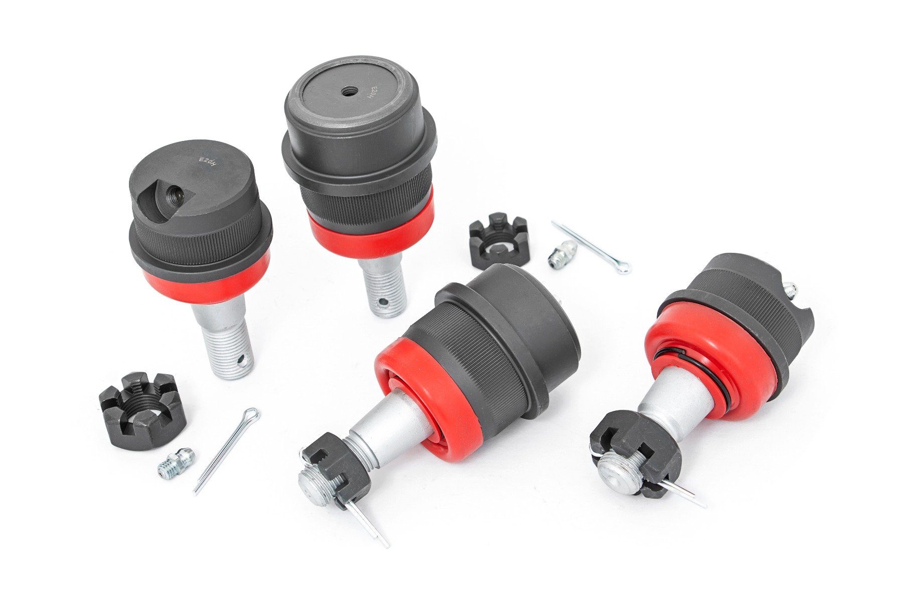

These are the exact same balljoints as teraflex, Yukon, mopar etc. and are cheaper. The rebuildable and the other balljoints that are $300 plus are a waste and won’t last any longer. They all have plastic inside that wears out. These are what I would get.
That’s a killer price. Even Synergy’s just went up in price to $300 for their basic ones.
If I had to guess the bjs in there look oem
Easy way to identify is if you see a zerk fitting on top of the uppers which will mean aftermarket. If they are aftermarket, pay attention to what comes as in, if they are knurled or not.
