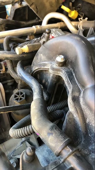

I have a 2019 JLU with a 3.6L, I have just sold my JKU 3.8L, the JLU seems a lot noisier than my 3.8L, I even took it into the dealer to check out incase I had a bad lifter, they claim its noisy injectors and its normal for a 3.6………..is it normal After 18000 Miles

If you're able to post a video, please do. Some vehicle's injectors are indeed noisier than others.
