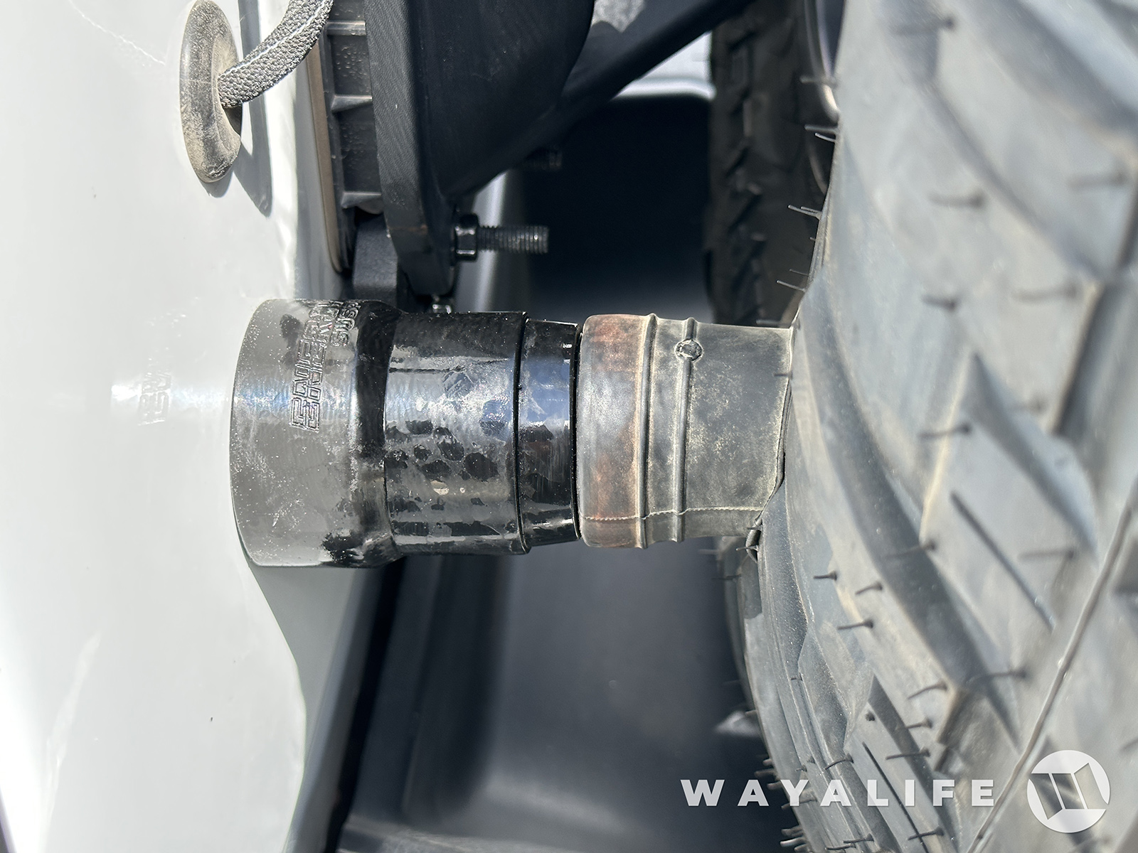

So, mine has been holding up well but I did extend the bump stops so that they're pressing against the sidewall. I did install the Energy Suspension ones BUT THEN, installed the factory rubber ones on top of them. Essentially, I cut off the nipples, flipped them over and plugged them into the Energy ones.Eddie, I read through good chunk of this. How’s the Mopar HD Tire carrier holding up? My 392 came with one installed, has spacer but I’m not reaching bump stops, having the same wheels you do, I’ll look up the energy suspension ones and hopefully that’ll at least squash against the tire. But curious how it’s been as whole.
Thanks for the feedback and pic!So, mine has been holding up well but I did extend the bump stops so that they're pressing against the sidewall. I did install the Energy Suspension ones BUT THEN, installed the factory rubber ones on top of them. Essentially, I cut off the nipples, flipped them over and plugged them into the Energy ones.
Glad I could be of helpThanks for the feedback and pic!
