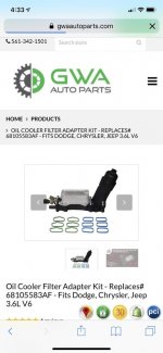

Just got off the phone, they are now claiming that the engine cooler was the source of the leak the first time because the engine cooler i had recently installed was the wrong part for my jeep and replaced it. I have a copy of my order that states specifically the oil cooler was for a 3.6l jeep jk. So now im thinking they sold me a part that i never needed and charged me for parts and labor and never fixed the real source of the oil leak at all.

Not sure if you are aware but the 2012-13 had one oil cooler and the 14’s and newer have a different one. The only change I’m aware of is the type/style difference in oil filters. I have a 13 and if I have to replace my oil cooler I plan on putting one in for a 14+ to get the new style filter.

I know they are interchangable, i did research befofe buying on here.
