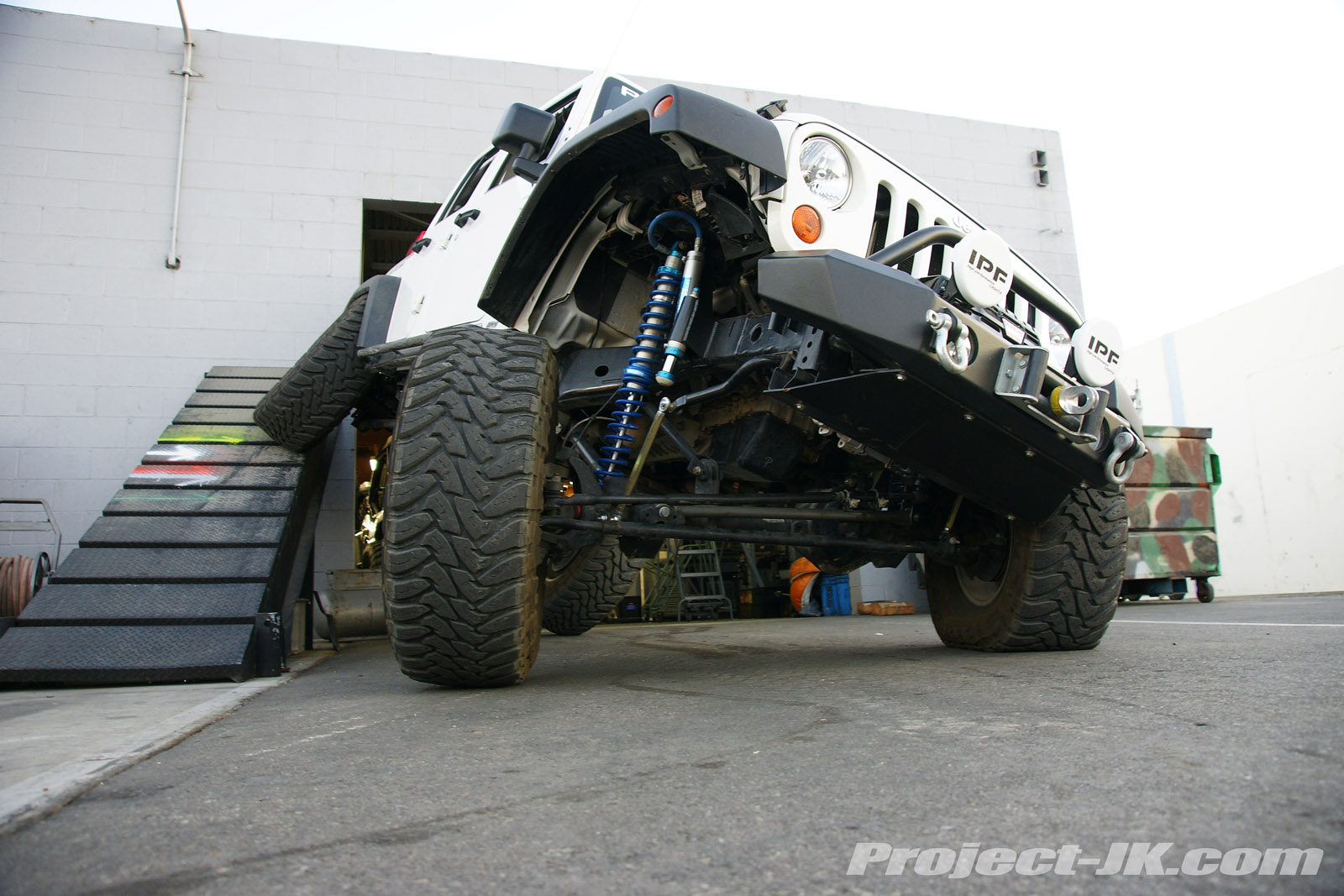

Here's a couple of shots of 14" coil overs running short arms.
We ended up having to install limiting straps to help prevent drive line bind. We still run limiting straps with our long arms for the same reason.
Can't really see the front driver's side to see if it's all the way into the bump but I'd imagine it's pretty close. And the passenger shock looks fully extended.
Even looks like stock arms and not aftermarket, right?
