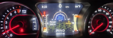

I just went outside to get a shot of the dash display that shows 'mpg', if I can include it. Jeep dash display.jpgI don't know if your Jeep is the same as mine. In the picture, it's the orange part that's reading "0 Current" beside the fuel gauge. The Jeep is parked, not moving, engine at idle, thus the "0" mpg.
If you have a selectable display like that, it'd be interesting to see if your 'mpg' changes like mine does as you descend. To me, perfect engine "hold back" descending shows 99 mpg (no engine load/throttle closed), and moderate RPM of from 1,000 to about 2,000.
I just went outside to get a shot of the dash display that shows 'mpg', if I can include it. View attachment 428597I don't know if your Jeep is the same as mine. In the picture, it's the orange part that's reading "0 Current" beside the fuel gauge. The Jeep is parked, not moving, engine at idle, thus the "0" mpg.
And yes, I think the "free spooling" you're sensing could be this.

My dash display looks similar to yours. I expect that the "free spooling" happens when the transmission changes to higher gears. Since I have enabled showing the current gear (something you should do), if I was paying attention I would likely notice that the transmission has changed gears. Unfortunately, I am unable to verify for quite some time since I have left the mountains and am returning to a flat world.

When I took that picture it was sitting, idling in Park. Once I put it into gear it does show a display of which gear it's in. It will show "M3" for instance when locked into 3rd. Or a "D" and the gear it's in when shifting automatically.
