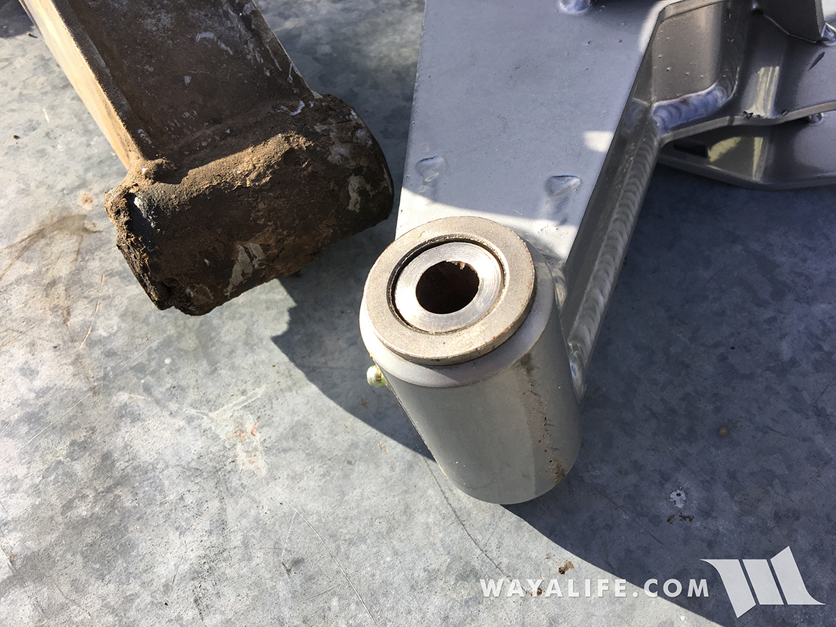

It's a crush sleeve that is surrounded by metal bushings with very tight tolerances.
And here's a close up of the bushing.

Question Eddie was it obvious that the cantilever was bad or did you have to find it to figure out that it was bad?
Short term do you think you could've have driven Moby longer like that and not noticed the bad cantilever
Oh, I've known something was off for a bit, I just was too busy wheeling and working on other Jeeps to address it. First sign of something being wrong was obnoxious squeaking that we'd get from time to time. That alone was a red flag but even after giving things a thorough visual inspection, it was difficult to spot. I had planned on taking things apart but just kept putting it off until I started to hear an occasional clunk. That's when I started to look harder and noticed the passenger side cantilever arm leaning in a bit.
It might be hard for some to see but upon a closer look, I could totally see that the bushing was blown.
Even after knowing the bushing was blown, I still added another 1,000 miles or so with some hard high speed wheeling in between. So, to answer your question, yes, I could have driven Moby longer but I definitely knew the arm was bad. :crazyeyes:
