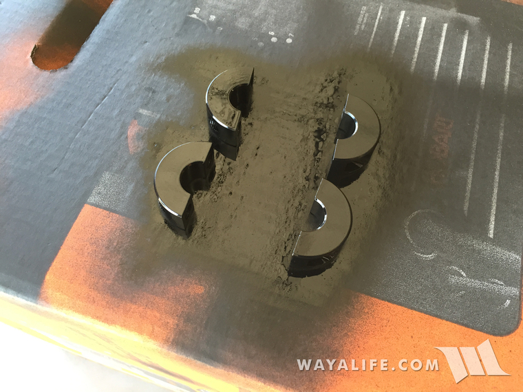

1. The shaft collars that I bought are black-oxide steel and while they do offer some corrosion resistance, they will develop some surface rust over time, even in the best of conditions. Because of this, I elected to spray some frame paint prior to installation.

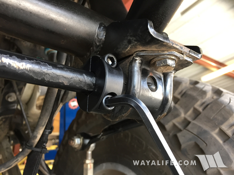

3. Place the 2 halves of the shaft collars on to your JK's rear sway bar and up against the inside of the driver side frame mounted bushing as shown in the photo below. Use an 1/4" allen wrench to secure them in place.
4. Repeat step 3 on the passenger side of your Jeep.

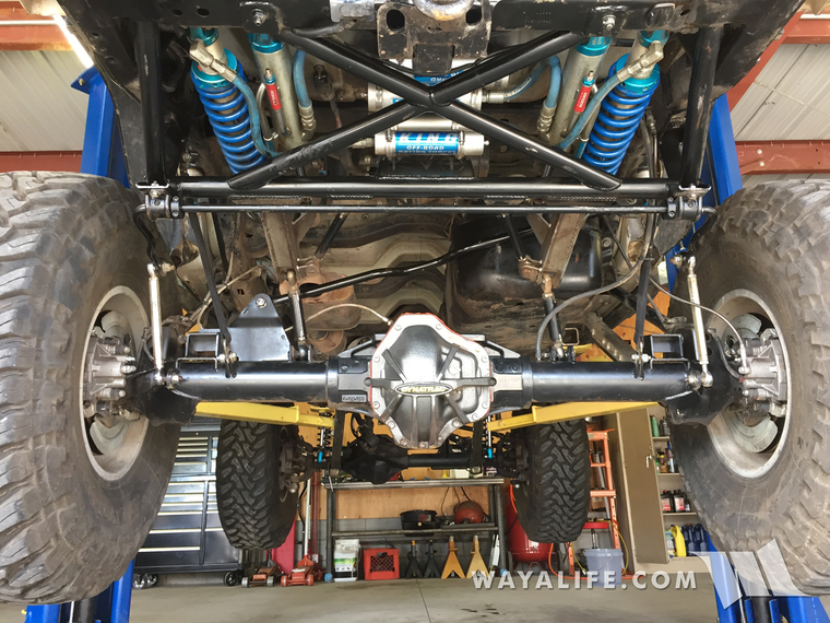

Finally, here's a photo from further back to show what the shaft collars will look like installed on your JK rear sway bar. As you can see, they are hardly noticeable.
That's it! Your JK rear sway bar should now stay put and no longer shift around. Because I chose to order up a set of Extra-Grip shaft collars, they ended up costing me $26 but, you can use standard shaft collars and they will cost less. I ordered my shaft collars from McMaster Carr and the part number for them was #8386K38. They are sold individually so you will need to order 2 of them. I hope this helps you out.
