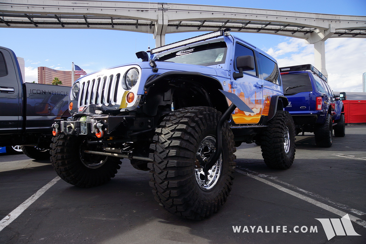

Daystar first brought this nice 2-door Jeep JK Wrangler out to SEMA back in 2012 and with a HEMI under the hood. For 2016, they've brought it out again only this time, with a nice stretch and Road Runner graphics on the sides.
That's a cool unique build. I even like the green rope on the winch. Voodoo I'm guessing.
I love the Frenched tail lights.
I wish Jeep made a stretched 2 door JK. The only reason I bought a JKU was for the added cargo space.
I think it's their new kit could be wrong though
Never seen anything out of Daysytar other than spacer lifts, no coils up until now so it might be interesting.
I like. How much of a stretch is that and which brand? Most Stretchs use coilovers but this stayed with springs and shocks.
Rock Krawler does stretches without coiloves, they move the coil mounting brackets and weld off the front of the axle. You can kind of see it in the on the front side of the rear axle.
Other things I noticed, it looks like a camera on the bottom of the rear diff. Also what are the 3" is long gray things on the front and rear bumpers?
And I like the front bumper.
You are right it is daystars new kit. They posted about it here earlier in the spring
That is one of our latest kits, 3 inch stretch.
