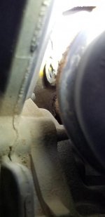

If it's the oil cooler, there will be oil near the oil filter in the valley between the valves. Pretty sure that's what mine has as oil mysteriously shows up on the mating surface of trans and engine then leaks down onto the crossmember. Makes it real nice when it drips on the exhaust crossover.
