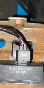

Ok so I went to do this yesterday and in the wire loom next to shifter there was 3 purple wires with a blue strip just all different colors of blue. FML
I pulled the center console up and at the TC I found this plug and see there is again 2 purple and blue strip wires.
Do I cut Light blue or Dark blue?
Also, will this mess with the elockers in anyway?
EDIT: I would think running the switch right to the J6 breaker in-line with a fuse would accomplish the same thing right?

I did the one in the bottom pic, far left.
Purple with grey stripe
