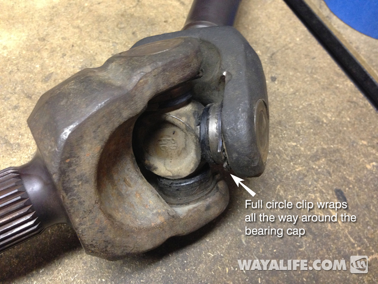

Okay, I just took some pics and looked for others to help illustrate things for you. This first shot shows a typical u-joint along with a standard C-clip on the left (what comes on factory axle shafts) and a full circle clip on the right (what you typically get on a chromoly shaft)...

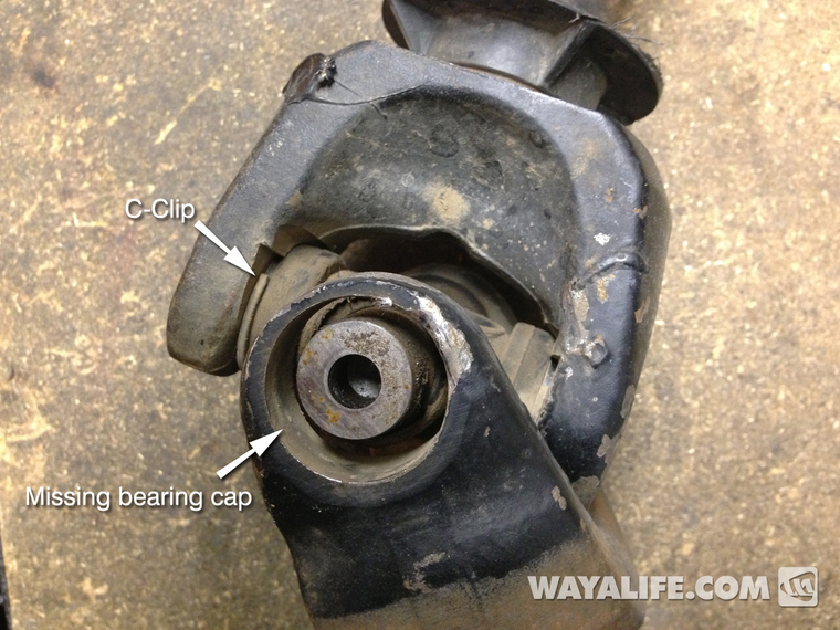

This shot shows how a basic C-clip is installed and what can happen if it gets pried off. As you will see, without the bearing cap in place, the trunion is left to tear off the ear of the yoke...

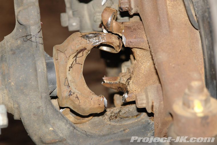

Here is a shot of a typical front axle break. As you can see, it occured at the U-joint and most likely because of a bearing cap had been lost...
Here's a shot of chromoly shaft with full circle clips installed. Notice how the clips go all the way around the bearing caps. There is no way for them to get pried off...
I hope that helps you to see things a little more clearly. :cool:
