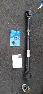

I have the Dana Spicer front driveshaft.
Very solid. No Chinese flange or joints like then woody 1310. On the 1310 debate. All the other manufacturers offer a 1310 or a 1350, none offer the oem 1330. I still run a dana 30 with 488s and an eaton limited slip so I thought the 1350s may do more damage if it sone how were to let go.. just my thought when I made the purchase. It was $470 from quadratec. Im in NJ so it came the very next morning. My only complaint is the horrible finish. Looks lIke my 4yr old spray painted it
Lol
Yeah pretty poor paint finish for sure. When I recieved mine it was in a very nice Dana/Spicer HP shaft box but had NO packing material what so ever 😡 And while looking it over I noticed one of the bearing cap retainers ears was broken off and I found it floating around in the box.
The shop I bought it from was on the east coast so I contacted them explaining the broken part and the lack of packing material he hung up the phone with me and contacted Dana and the next day I talked to a person from Dana and explained it all again. Took some pics of the damage and sent it to Dana.... they had a new shaft sent to me over night 👍 They didn't even wait for them to receive the bad one....great CS
The kicker was the new one was packed the same way....no packing material 🤔 At least this one was all intact.
