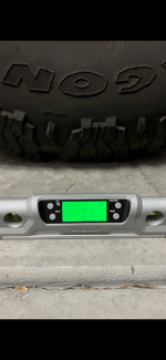

I can't speak for anyone else but I personally noticed more steering issues when it was cold out. I do know of others who experienced the same. I have NOT had any problems what so ever since installing the Synergy track bar reinforcement/sector shaft brace.I've been out of town, so haven't been able to get a toe measurement yet, but I did do a little deep dive and found the old posts about death wobble with the early JL and JT models. Was there any definitive answer to wether or not the temp played a role in the death wobble or steering feel. It was in the 60s in vegas today and driving around I almost want to say it felt a little better driving it around.
I had that synergy sector shaft brace installed before I lifted the Jeep. Had it removed so I could get the steel steering box installed. Steering felt the same with it off but I only drove around for a few weeks before having the steering box replaced. At the moment, I haven't put it back on yet.I can't speak for anyone else but I personally noticed more steering issues when it was cold out. I do know of others who experienced the same. I have NOT had any problems what so ever since installing the Synergy track bar reinforcement/sector shaft brace.
That is pretty cool, thanks for sharing.Those alignment bars are stupid expensive for what they are, get yourself a few short sticks of 1" x 1" x 1/8" angle and drill a few holes in them
Whether you buy them or make them I can’t think of a safe way to put the weight on the knuckle with this type of tool. Seems to be a accurate enough. I do set my stands today be as close to ride height as possible. Toe and steering wheelGreat idea, thanks. I see you have the axle on jack stands, do you believe you’re getting an accurate measurement? I know some say there needs to be weight on the knuckles for the measurement to be accurate. I’m curious because I’ve wanted to buy or build a set of these too. Thanks!
Nice, I think I’ll make a set of these then. Thank you.Whether you buy them or make them I can’t think of a safe way to put the weight on the knuckle with this type of tool. Seems to be a accurate enough. I do set my stands today be as close to ride height as possible. Toe and steering wheel
seems to get knocked out of whack a little on every hard wheeling trip I do
I have cross checked by scribing a line on the tires and using a tape measure or I also tried a toe gauge (bar with uprights) like they used to align cars before they had laser alignment racks. The toe gauge doesn’t seem to be designed for 37” tires, the spot you line up with the scribe marks is near the bottom of the tire. I think it was more designed for passenger cars and smaller trucks.
I have also done an alignment using strings on each side of the Jeep but that was after doing the long arm conversion to check the thrust angle and a few other things
