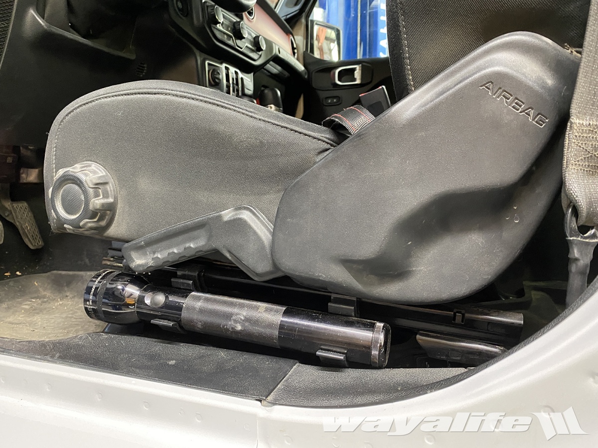

So this was kind of lame. This afternoon, I opened the door to my Jeep JL Wrangler and found this - a limp seat lifter lever.

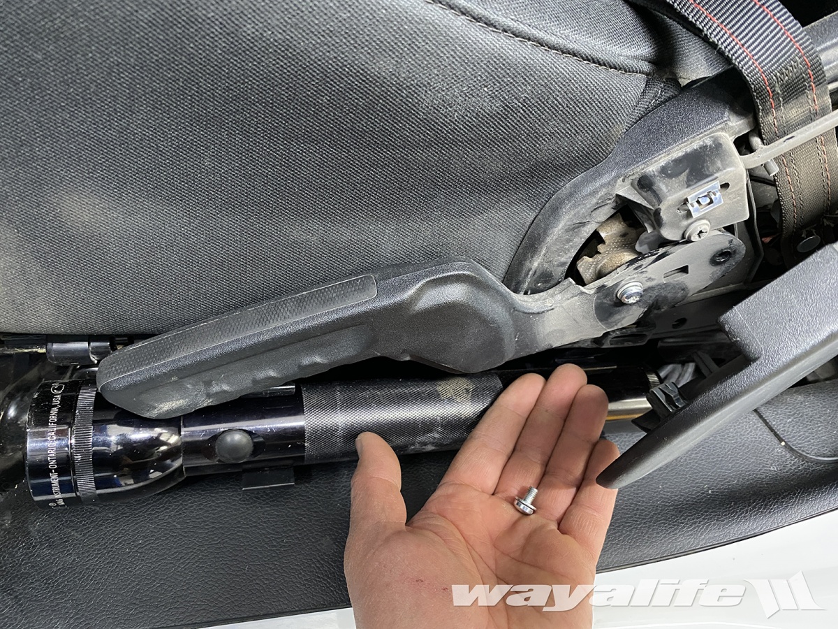

After taking things apart, I found that one of the 2 bolts that hold it in place had come completely out and the other was just hanging in there by a thread or two.
Anyway, I thought I would share this here just in case anyone else has noticed their seat lifter lever getting loose. Even if not, I might recommend you preemptively give these bolts a look as they are specialized and it would suck to loose one or both of them.

LOL - yeah, Cindy uses it whenever we go wheeling so ours gets used but really, I would have thought the damn thing would have been made to be used. The bolt is only threaded part way. The shank part sits in between the handle. I think I may put a dab of blue loctite on them.
I was thinking loctite too.
