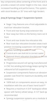

Ok, what am I missing here? This is the exact Synergy kit that you provided the part number for.
As for the ride, that’s obviously subjective and there are for sure different strokes for different folks. Me, personally, I’d buy the Rancho kit all day long and use the $1,000 saved towards the new wheels and tires.

Hmmm, that is interesting. I don’t remember that coming in the kits we install. I can tell you for sure we don’t install cam bolts in anything at the shop.
