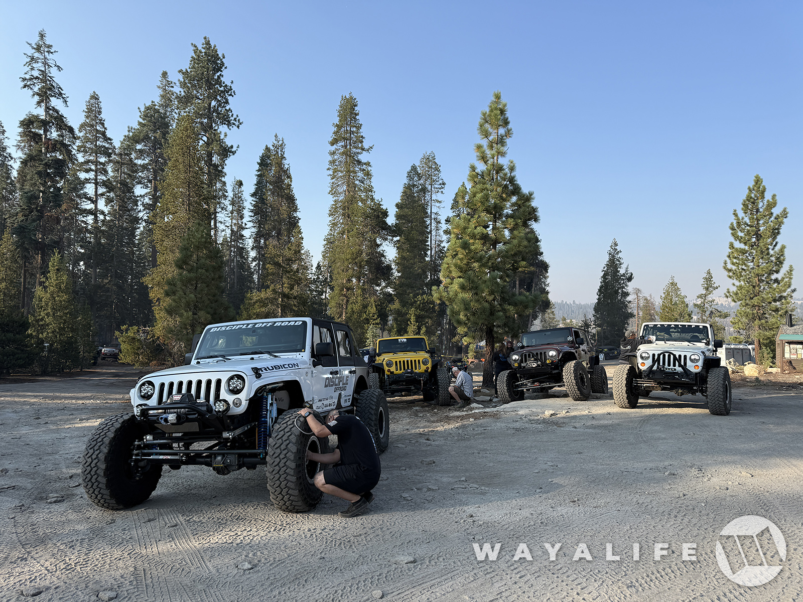

Time to air down, lock the hubs and disconnect the sway bar links.

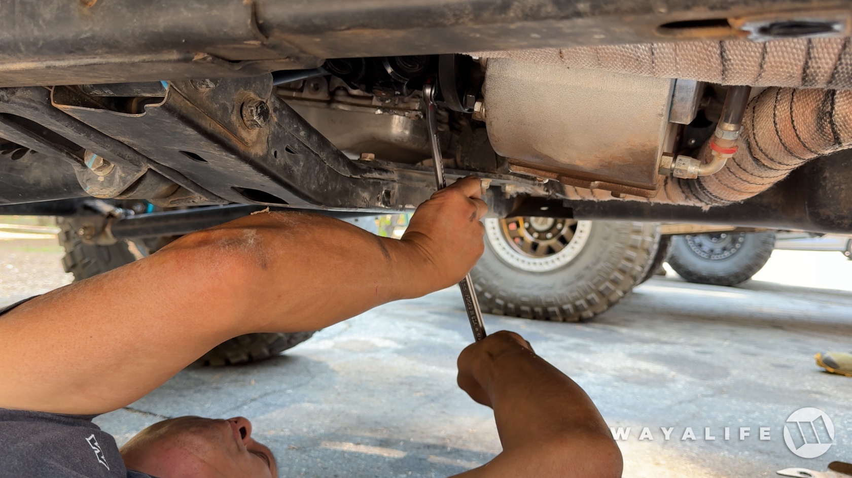

And, that's when our day came to a screeching halt or should I say, a BANG BANG BANGING halt. As luck would have it, the front drive shaft on Clay and Tracie's Jeep decided to separate from the transfer case, just as we started to head out to our trail for the day.
i.php
Not sure what exactly caused it but all the bolts securing the shaft to the output flange backed out and left the shaft to bang up the underside of their Jeep.
i.php
Amazingly enough, we were able to find 3 of the 4 bolts and pretty quicky. Two were laying in the middle of the road and nearby and one was sitting on the transfer case skid plate.
i.php
Unfortunately, we were still missing one and the thread on the remaining bolts were kind of boogered up. Needless to say, I went to work on trying to clean them up while Mike and Robyn went on ahead to see if anyone else in the group had one.
i.php
Although we weren't able to locate another bolt, I was able to clean up the threads and decided to try and get the drive shaft bolted back up using just the 3 we had.
i.php
And, that's when I found that the threads on the output shaft flange were jacked up as well or at least, on two of them. As I tightened up the bolts toward the end, they just slipped past the threads and could never get them fully tight.
i.php
After sending everyone else off to continue the run, we pulled the shaft and drove back in town where as luck would have it, the hardware store in town had metric bolts that could help get Clay and Tracie back in action. In the end, there was enough good thread in 2 of the holes that I could get a solid tightening of them using slightly longer bolts and the other 2 jacked up ones, I was able to use much longer bolts so that they went all the way through and secured them in place with nuts.

Question relating to Clay's problem with the Banana Split Mobile.
Would it be possible to drill the bolt heads and safety wire them in a Daisy Chain? I know we did it on drag bikes back in the day.
