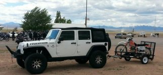

EVO 3" Enforcer is what I have on my 2014 JKUR. Best bang for the buck in my book. Price it at Northridge 4x4. Free shipping and if you can do the install you will save money and learn about your jeep.
Here are some shots of my JKUR with 35s cut fenders and the 3" Enforcer lift.
