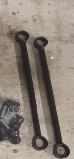

Well I guess its back to the drawing board. No way I was going to run the little factory whimpy bars when I had a nice new set of EVO end links. Except they were so dang long.
So being the crazy fabricator I am, Set the sway bar right at zero on the angle finder and measured away. Cut the new end links down and rewelded the end on.
Painted everything and mounted it all up. Well it looks good anyway.
So 15 degrees you say huh? Even with the King Coil Overs or is there another number I should go for due to the huge droop out these give?
Oh well I was kind of missing working on the Jeep.
