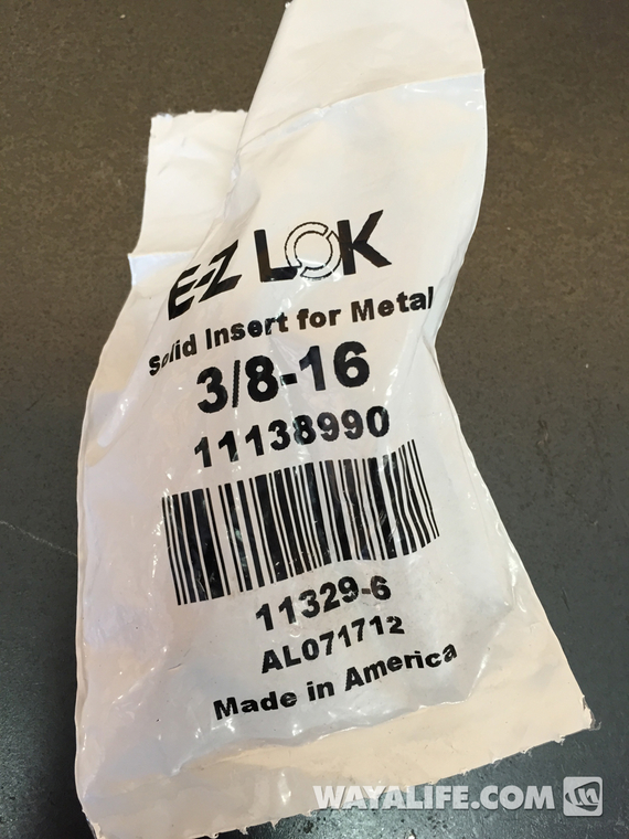

Using a pair of vice grips, we were able to remove the inserts from the bolts but not without damaging the threads on the inserts.
Fortunately, our local Fastenal had just what we needed - new inserts!
