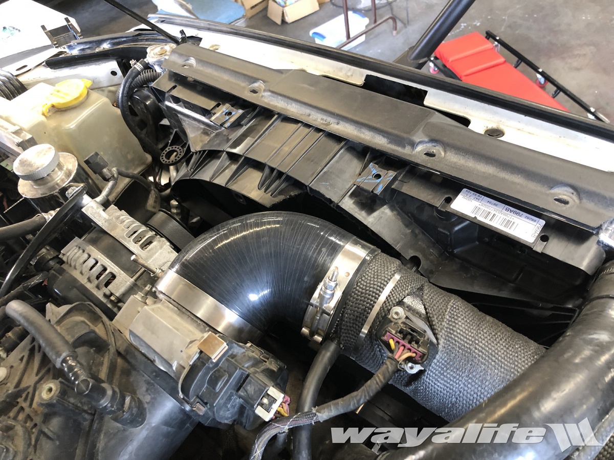

Yup, what you're looking at is the very first JL Wrangler fan installed on a JK with an LS!
It was a tight fit and some trimming of the shroud was needed but Robbie was able to get it in and his initial tests showed it to work well!

So, how'd everything work out? Well, when we left Motech, it was 104 out and the climb up to Indian Springs is typically a hard one. Essentially, there are 3 long grades you have to climb and with little time for your engine to cool off in between them and by the time you reach the third one, Moby typically ran pretty hot. In the past, we always had to make this climb with the AC off and even at that, we'd typically see a coolant temp in the 240 range and a trans temp at over 220. Not quite over heating but not good.
With the new JL Wrangler fan, Moby's coolant ran at a nice 221 the whole way up AND with the AC on the whole time!! Thanks to the new transmission cooler, it's temp never broke 170. :wings:
The rest of the drive home was only in the 90's and our engine was averaging a nice cool 208 or less. The further north we got and with the sun going down, the cooler it got and our temps really settled in at a nice 197 on coolant and 154 on trans.
So, I should note that before we left Vegas and while it was still in the triple digits, Cindy and I did some testing to purposefully get Moby's temps up. A lot of hard abrupt throttling and then coming to a stop and doing it again. Basically, making his engine work really hard and not give him a chance to cool off. This did get his coolant temp to climb up to 230 but the JL Wrangler fan kept it there. Trans never broke 200. This was a HUGE improvement over what we were seeing in the past.
Oh, one other side note, we had Robbie remove the speed limiter on Moby too. Before, we'd get up to 95 MPH and he'd top out. On the way home, I got him up and over 100 MPH :thumb:

When I first looked at this shot I have to admit I couldn’t figure out how you’d get this fan to work on the trail. [emoji23]
Glad to hear nothing is holding Moby back now too! [emoji1303]
Very cool.... not that it matters, but will Moby now have that loud fan noise on the trail like Jet does... or is that just a JL computer thing?
In theory, yes but so far, I haven't heard it get as bad as it can get on the JL. For the most part, it's pretty quite and when it does need to work harder, we've only been seeing it get up to 69%. I think the only time it got loud is when I was really pushing things and got the engine to 230 but that didn't last long. I think as a whole, the JL run hotter and that's why the fan on it is always screaming.
