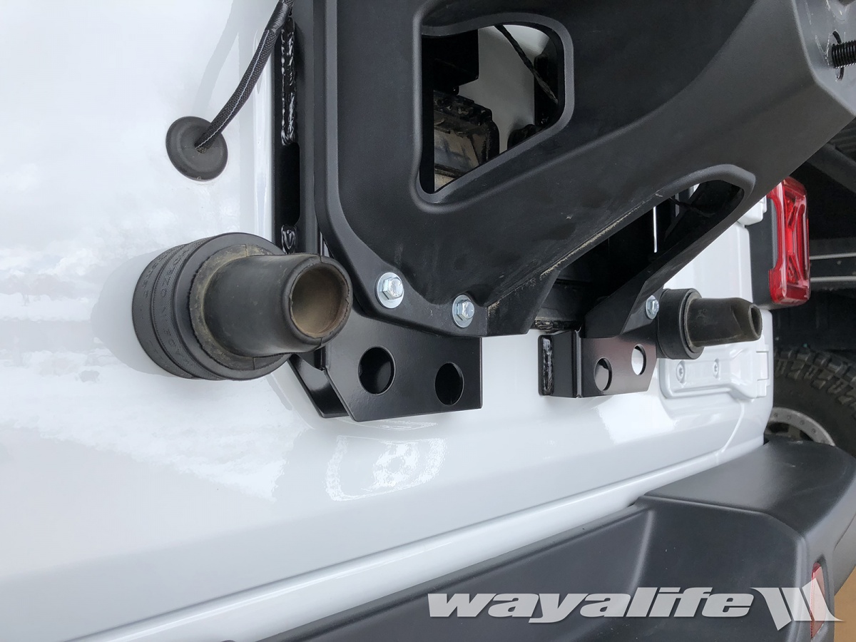

To help prevent the jiggling of the spare tire which ultimately leads to damage of the tailgate, the rubber isolators have to be extended. To do this, used a couple of old JK isolators that I had laying around and some hockey pucks. Why JK isolators you might ask? Because they are about an inch longer than the factory JL ones.
![20180320093151-0ac7a481-me.jpg](https://www.wayalife.com/photos/_data/i/upload/2018/03/20/20180320093151-0ac7a481-me.jpg)

I should note that in the write-up, I use a 3" machine screw but to make this work with 2 hockey pucks, you will need a 4" bolt.

And, the rubber isolators are pressing firmly against the sidewall of the spare.
![20180320093213-70629b8a-me.jpg](https://www.wayalife.com/photos/_data/i/upload/2018/03/20/20180320093213-70629b8a-me.jpg)
![20180320093215-238fad38-me.jpg](https://www.wayalife.com/photos/_data/i/upload/2018/03/20/20180320093215-238fad38-me.jpg)

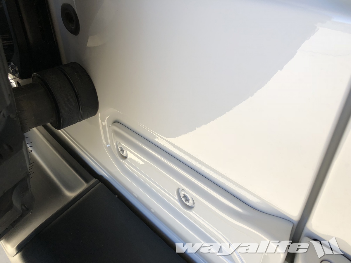

After giving things a closer look, I determined that I might be able to get the 3rd brake light to work too.
![20180320093227-7af47a5a-me.jpg](https://www.wayalife.com/photos/_data/i/upload/2018/03/20/20180320093227-7af47a5a-me.jpg)
All that would be needed was to raise the light brackets to the top holes.
![20180320093230-99ae3277-me.jpg](https://www.wayalife.com/photos/_data/i/upload/2018/03/20/20180320093230-99ae3277-me.jpg)
