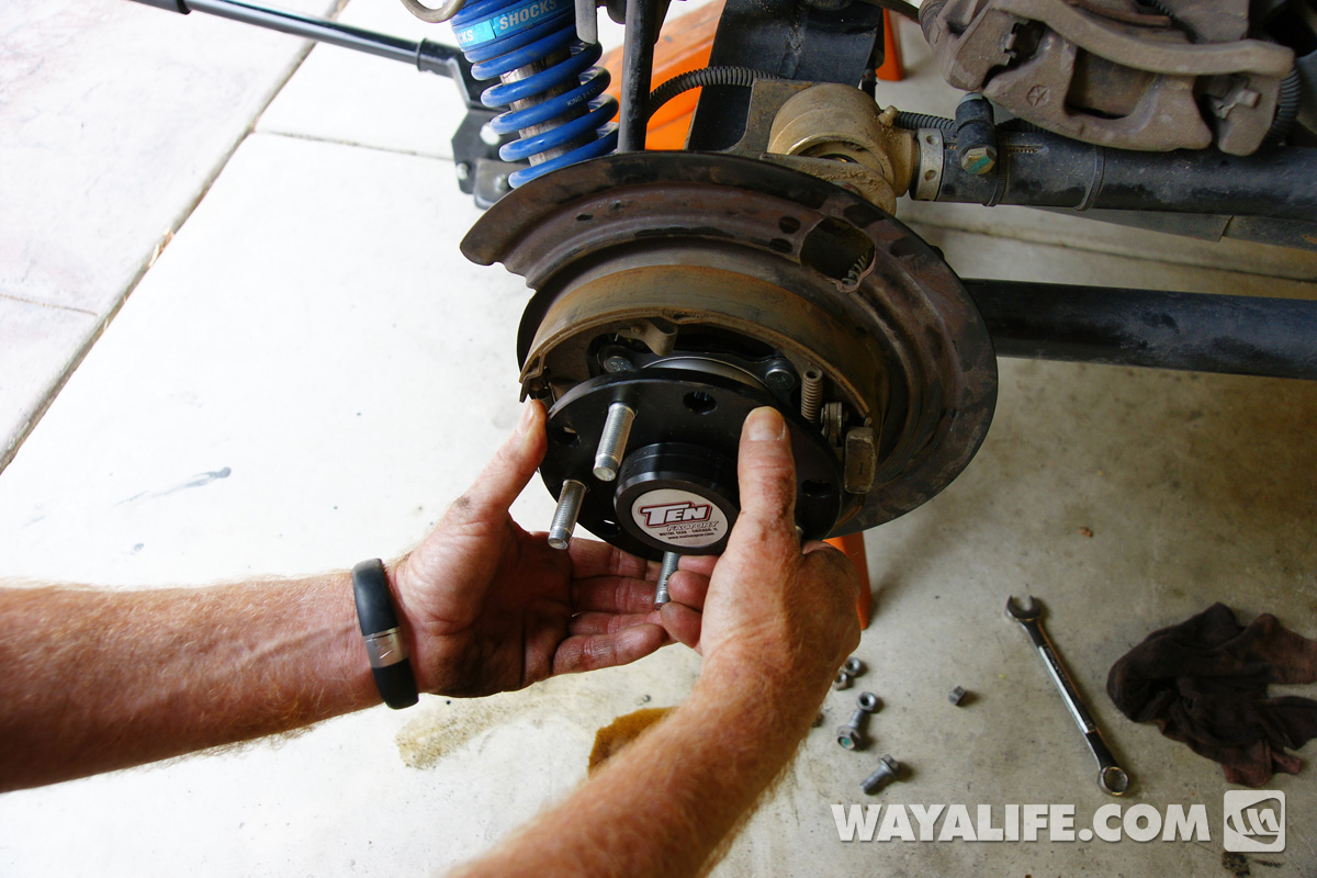

I have a question that will make me look bad but what is the flange?
The part of the axle shaft that these hands are holding.

Not always but if it were bent bad enough, yes. When it's slight, your brakes will chirp.
Trying not to continue this thread down the wrong path, but maybe my question will help others.
if the flange is bent, does the chirp only happen when the brakes are applied? or does it happen under normal driving?
Thanks for the video WJCO
Actually, it'll chirp while driving and then go away when you apply the brakes.

Normal driving. Instead of the rotor spinning true in between the pads, it wobbles and hits one of the pads on every revolution.
We had our RR tire hit last year by another driver on an icy road, she was doing 10mph or less. We didn't see any damage so we drove home. Within half mile, the chirping was there. Spinning it at home, axle was clearly bent. We parked it and had insurance take pictures, then we drove it to a shop to have it fixed (insurance work), less than 2 miles from the house. Rotor, caliper bracket, etc grenaded as I was about 50 feet from the shop, so I lost hydraulic brakes and emergency brakes, not fun. Moral, don't drive on that shit.
