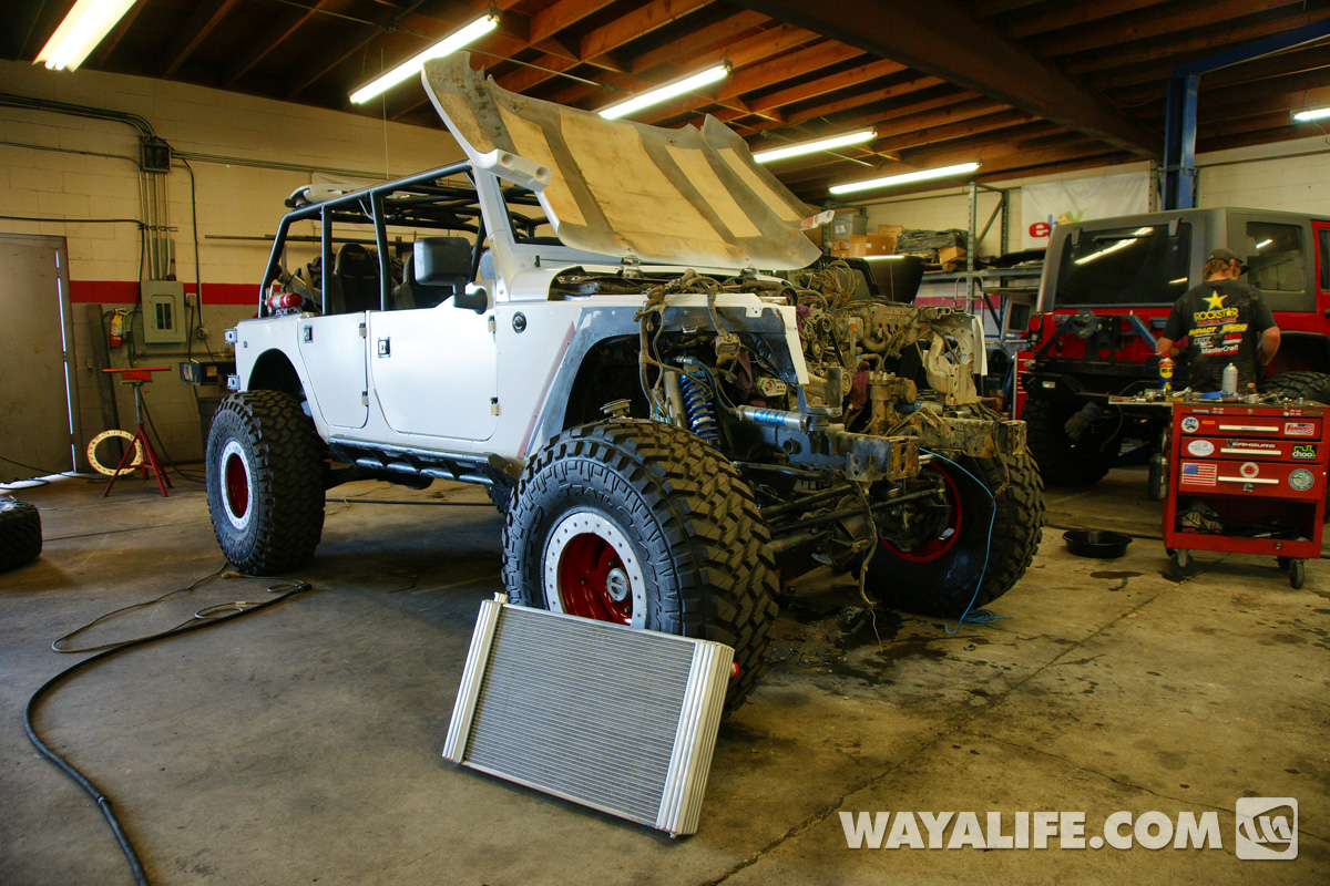

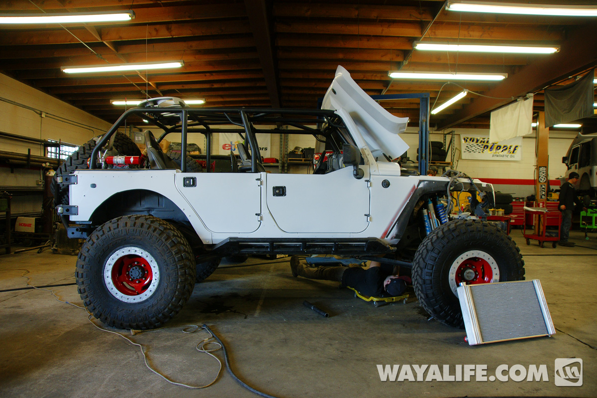

We stopped by Off Road Evolution today to check out the progress on EVO 1. Mel and crew are currently in the process of tearing out all the factory wiring in preparation for a motor and trans swap. :yup:

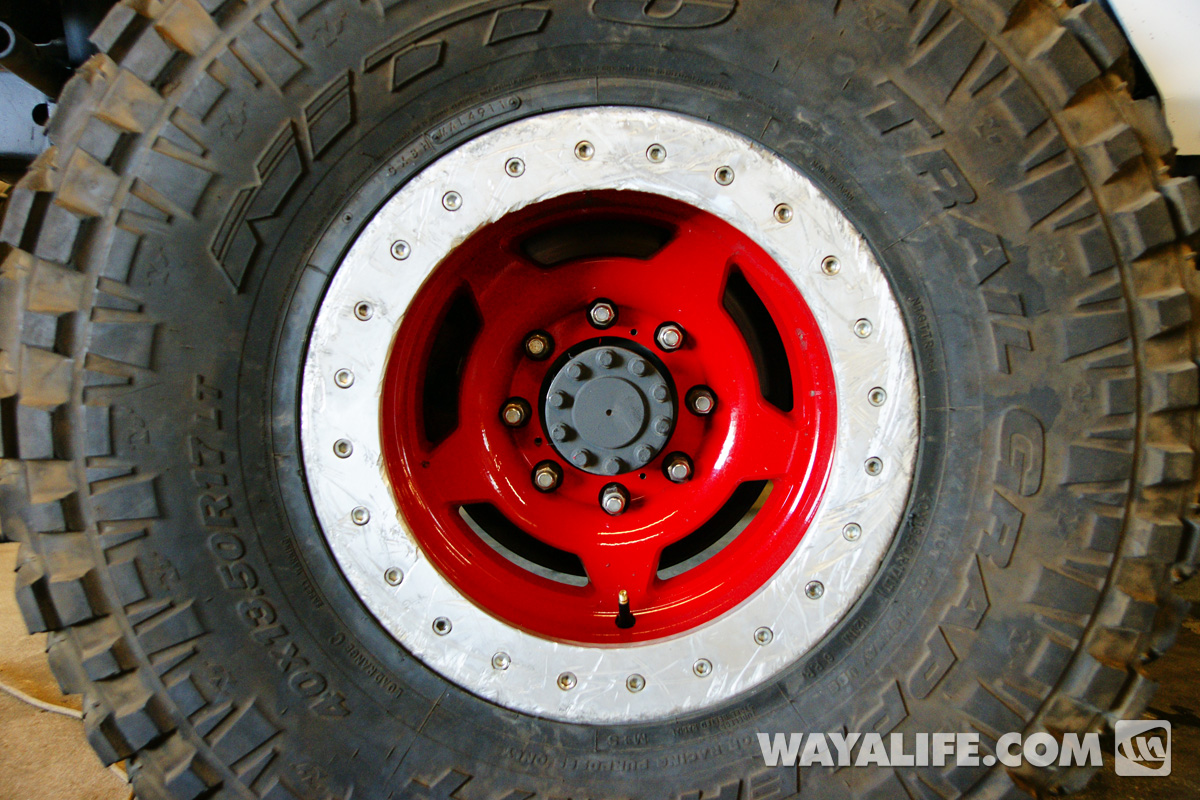

New red ATX Slab Beadlocks!

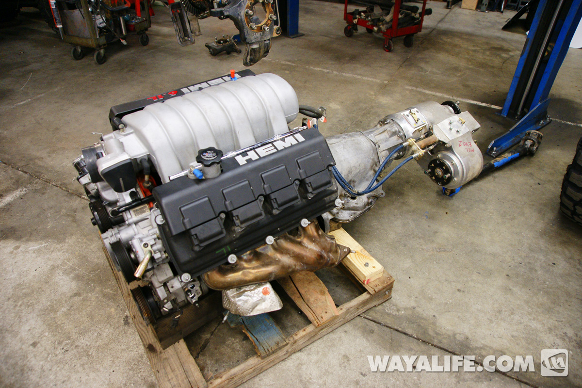

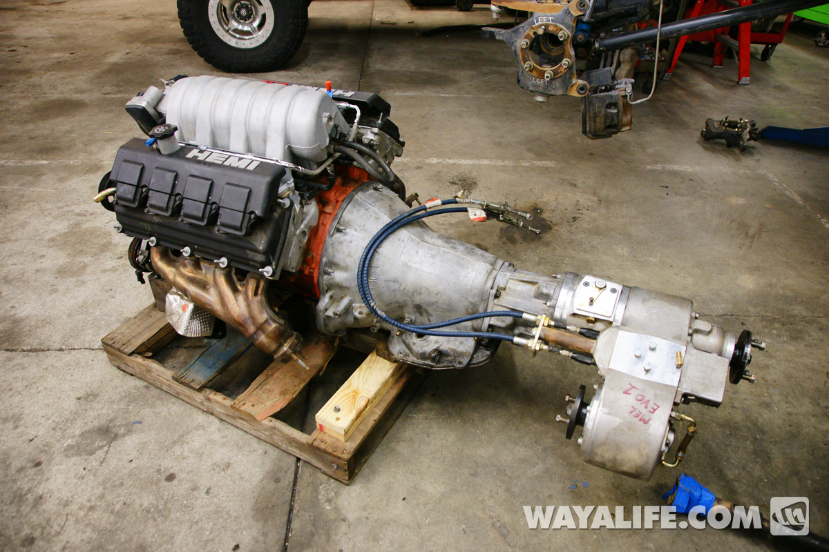

It's HEMI time for EVO 1! :thumb:

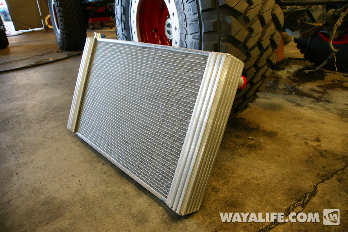

New radiator

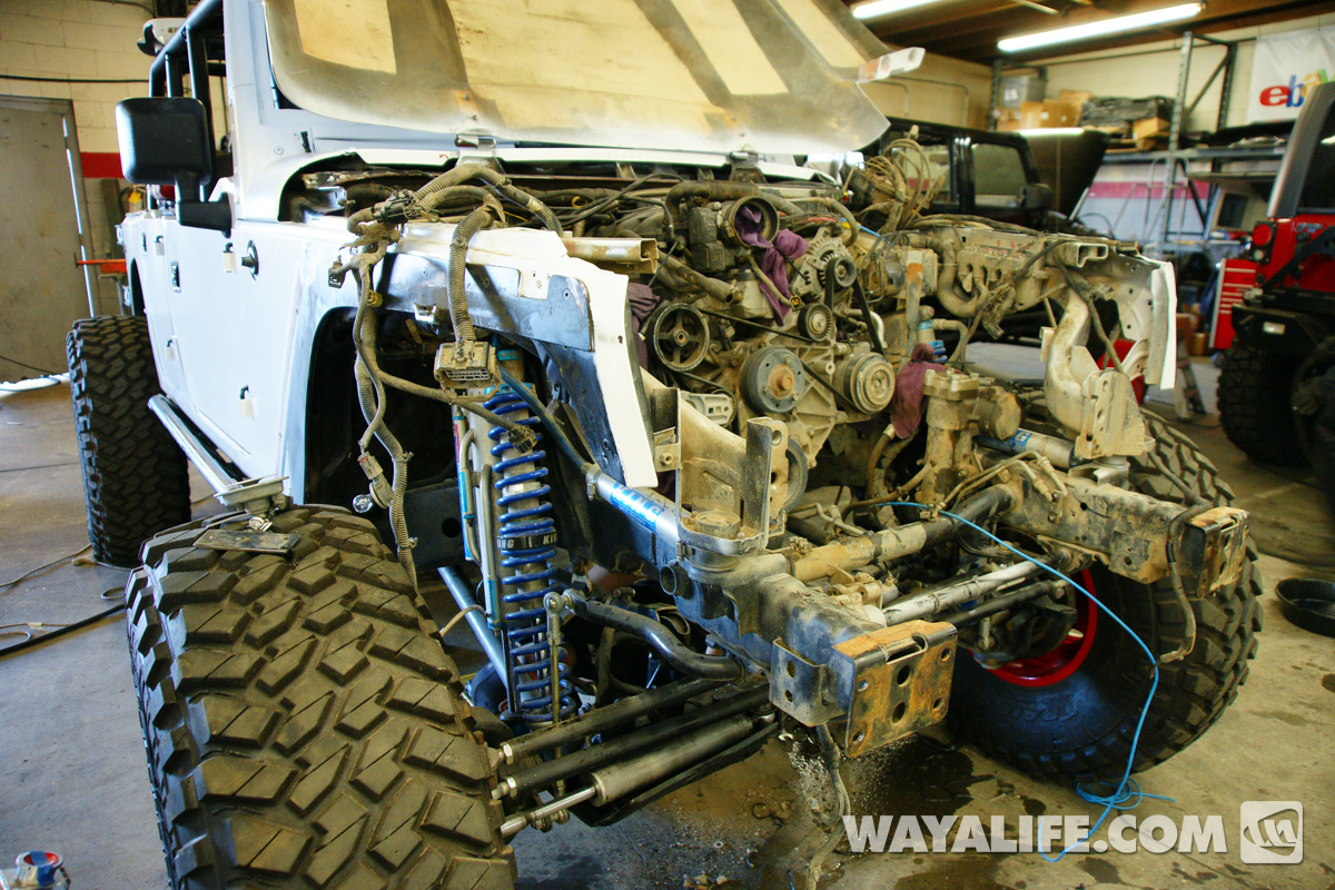

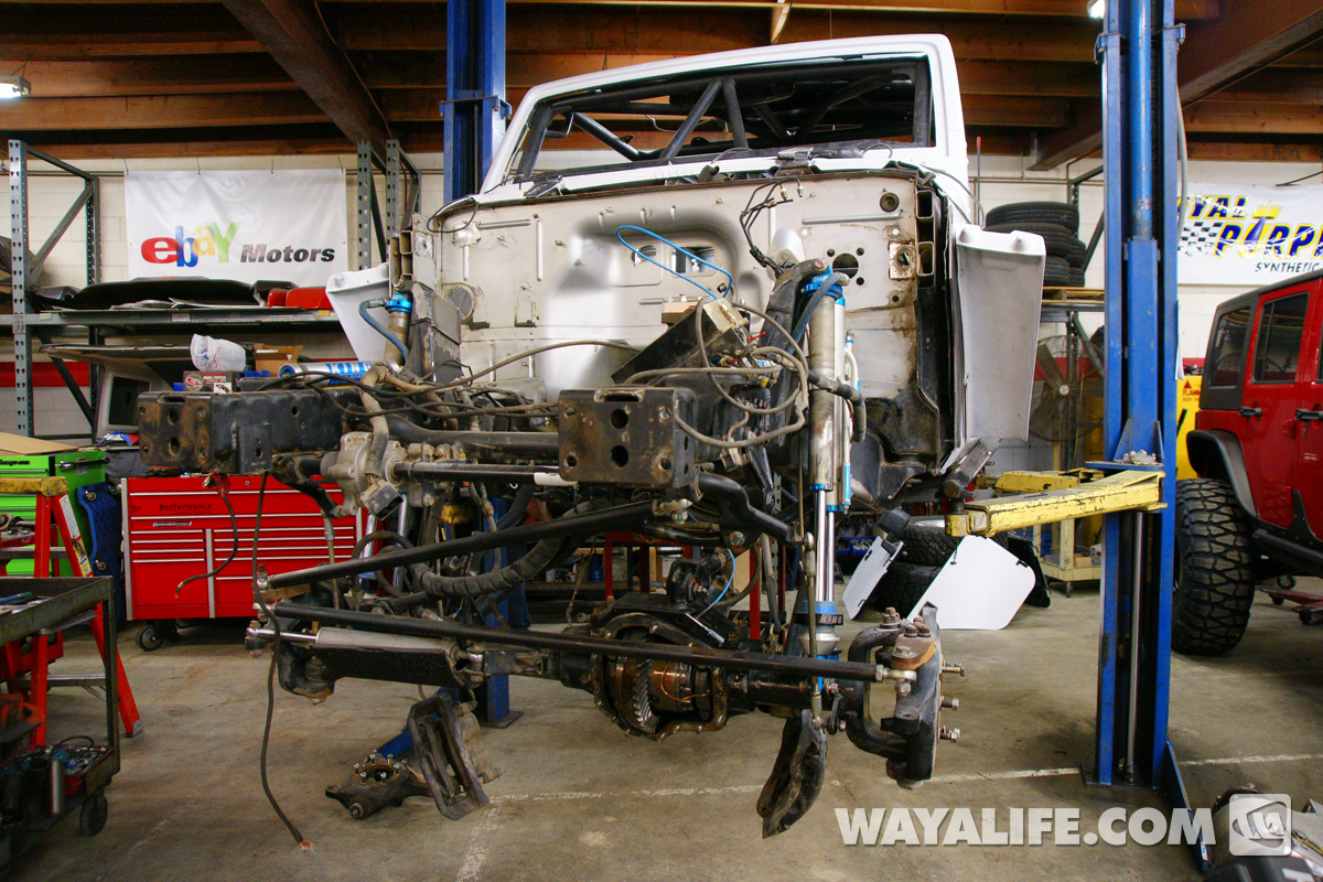

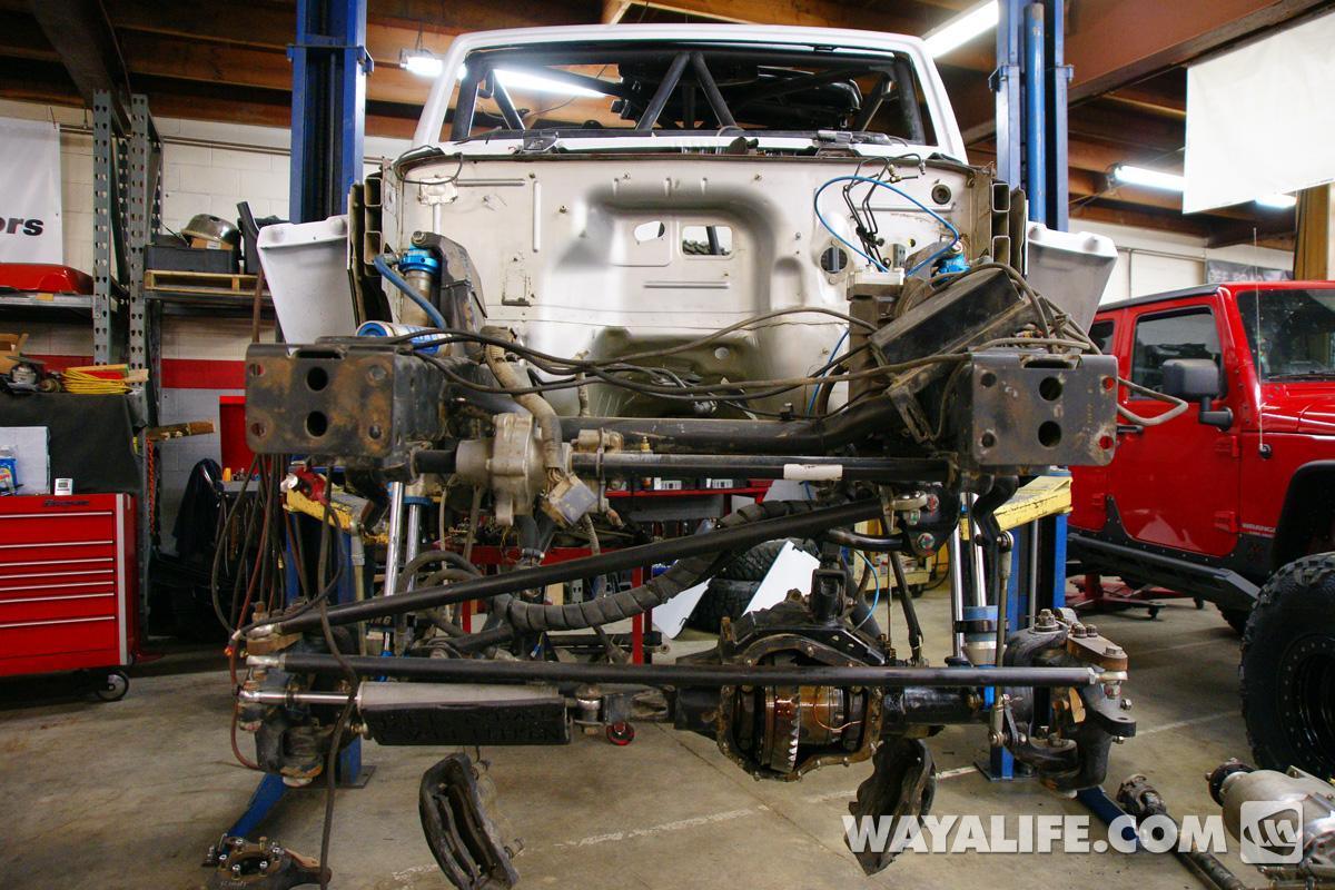

Out with the old 3.8
Doing some cutting

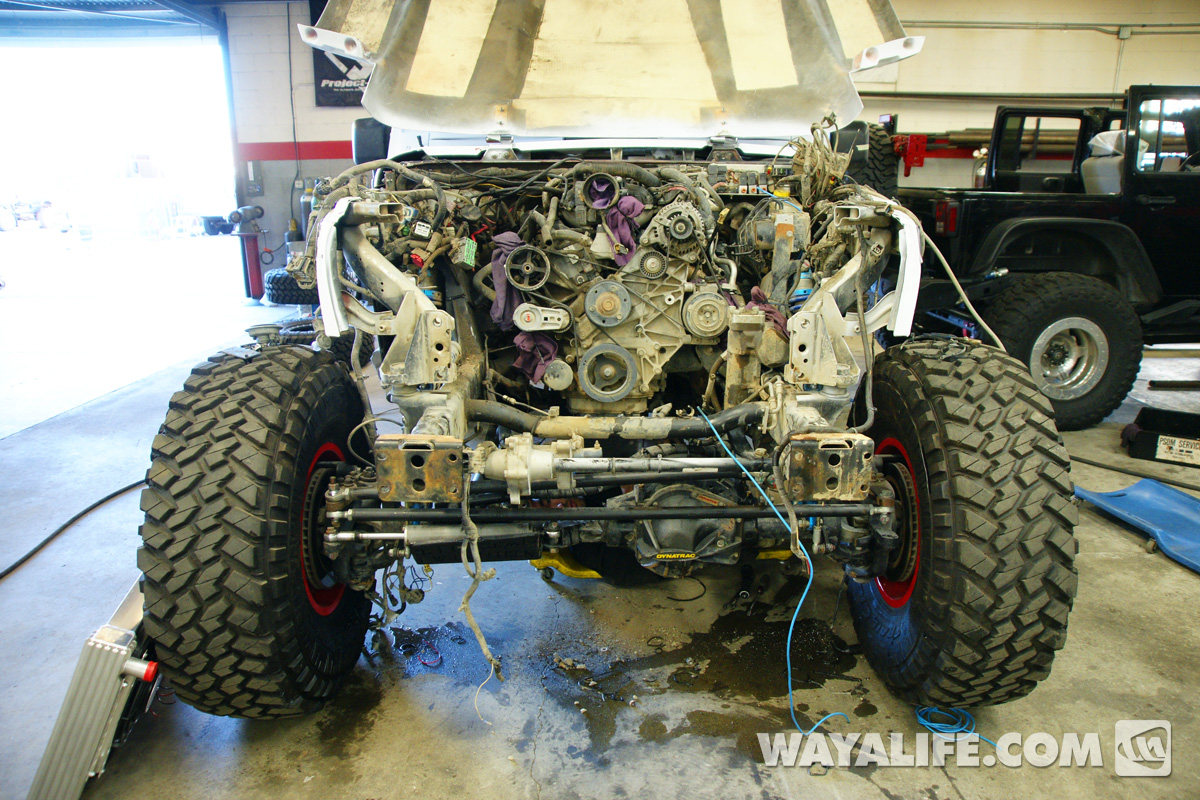

Cutting out the engine mounts
All cleaned up and ready for something new!

Parts for EVO 1 - atlas 4 speed and 727 trans

He's using a 727 trans? I know EVO 1 is a dedicated trail rig for the most part, but highway driving will be interesting with the 1:1 3rd gear and no overdrive. If it's a lockup 727 that'll help. Curious if Mel plans on sticking with the 5.38 gears or if he's changing axle gears. Cool to see him do his own thing instead of just going with the 5R45RFE tranny from the Ram/Grand Cherokee.

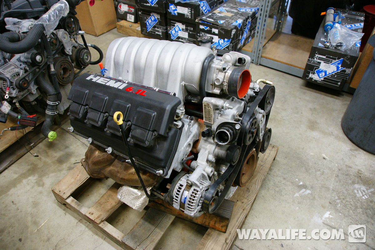

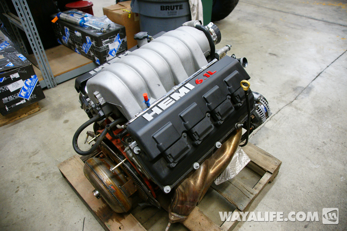

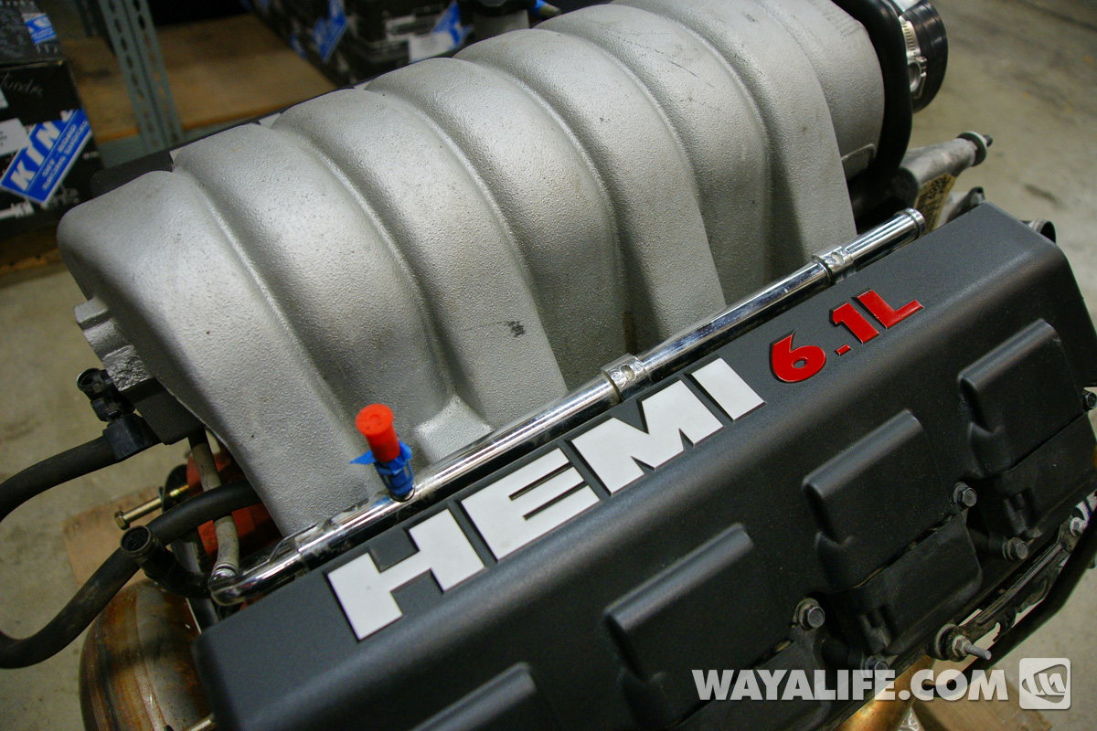

Here is EVO 1's new 450hp engine, 727 trans and Atlas 4 speed!
EVO 1 ready and waiting for install...

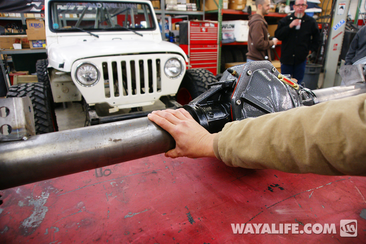

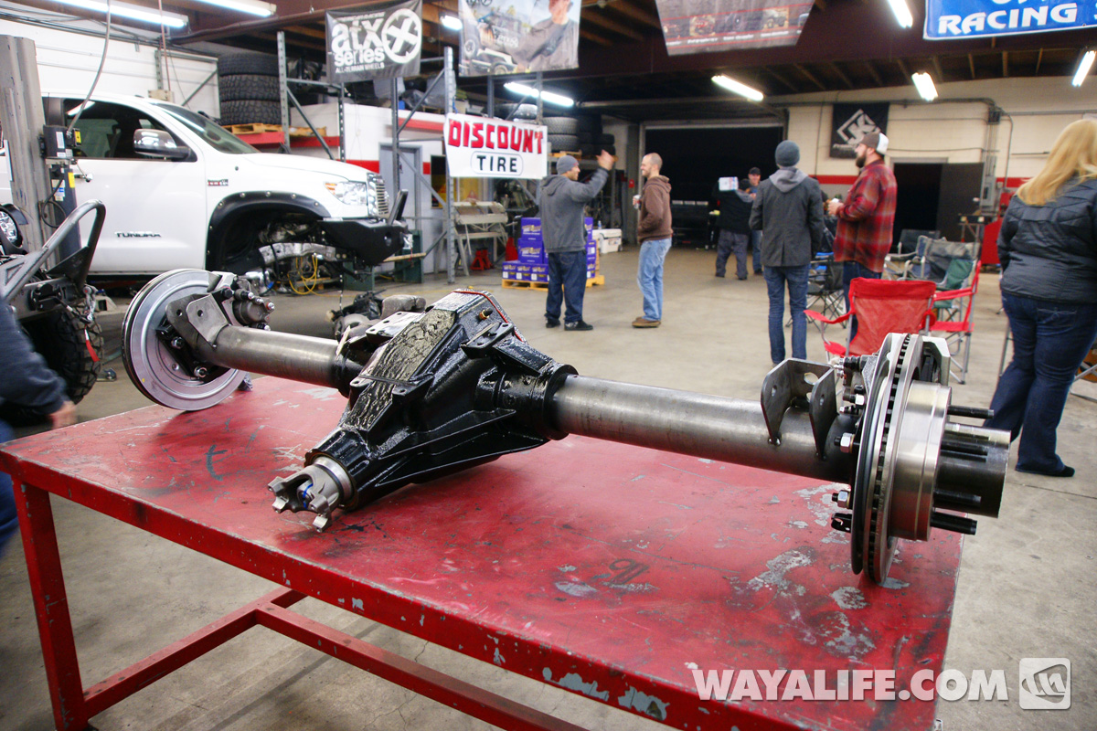

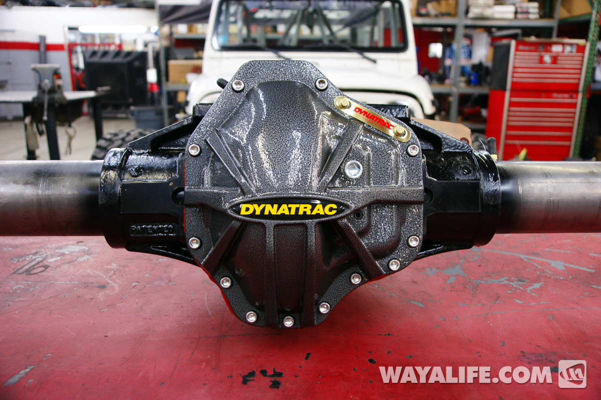

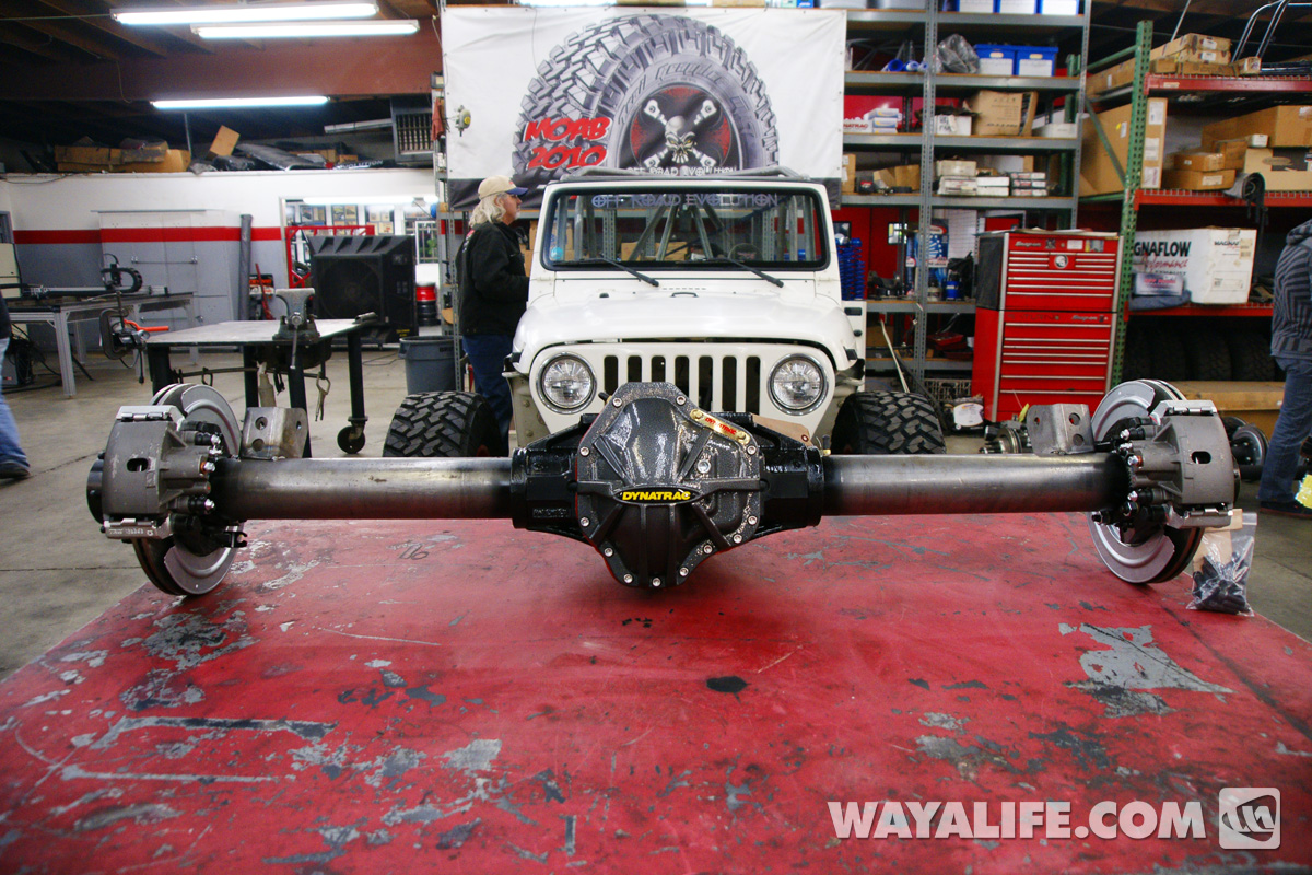

New Dynatrac ProRock 80 for EVO 1!! :clap2:
Look at the size of those axle tubes!! :shock:
