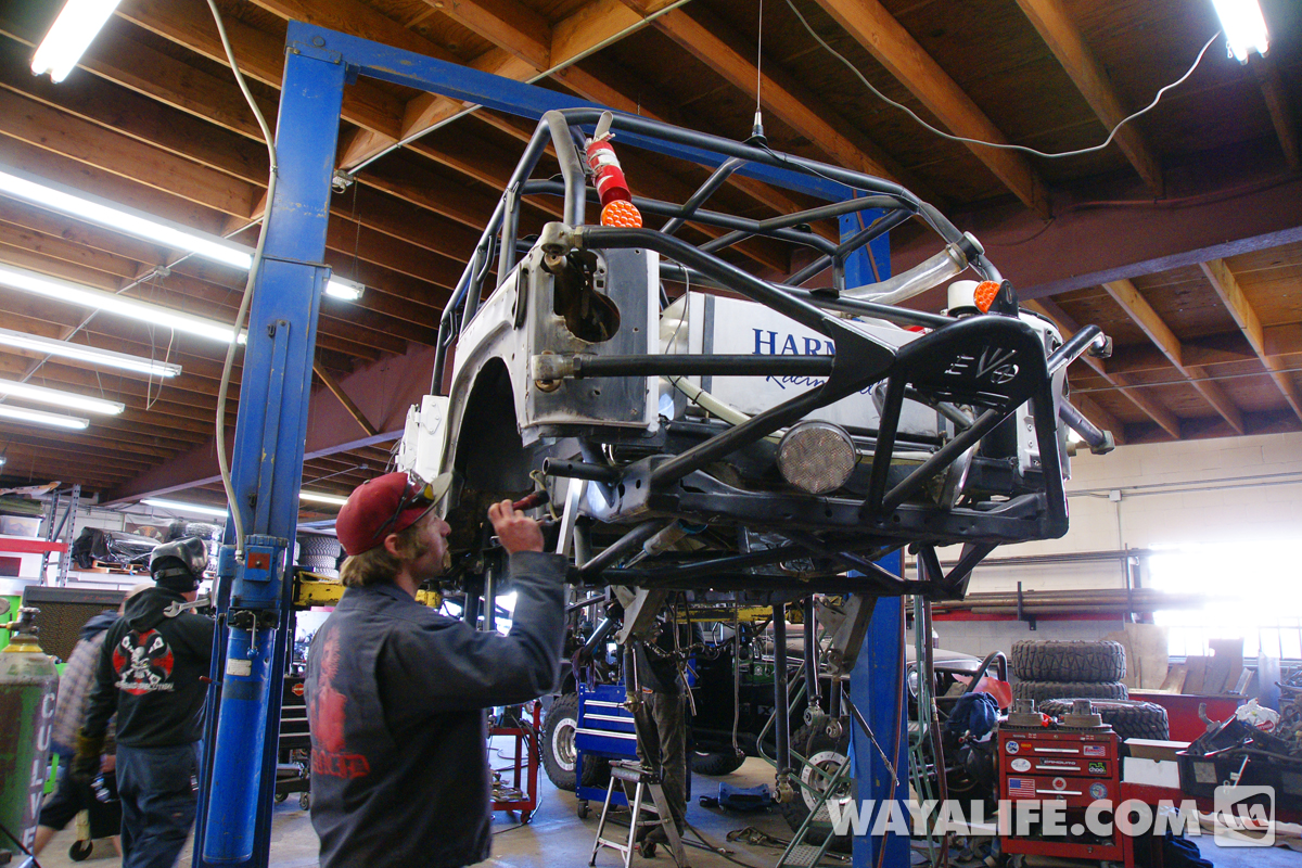

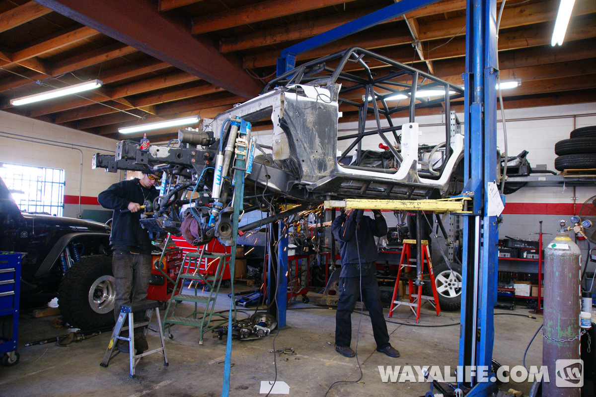

Stopped by Off Road Evolution on Friday to check out the progress of the KOH builds. Here are some updated pics of EVO 1:

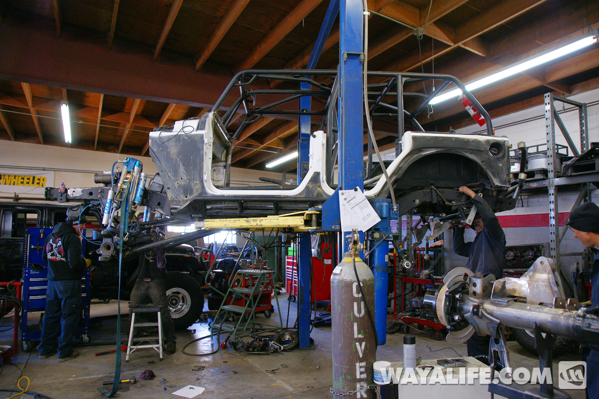

EVO 1 getting the full treatment...

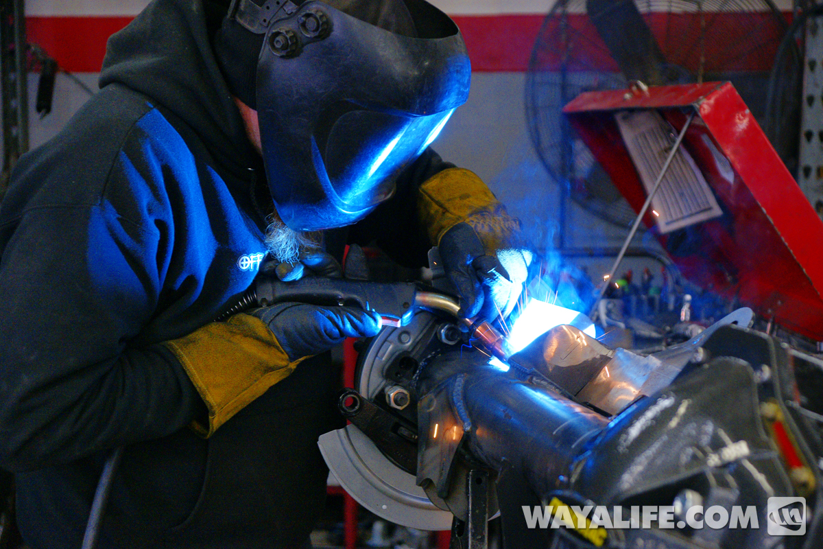

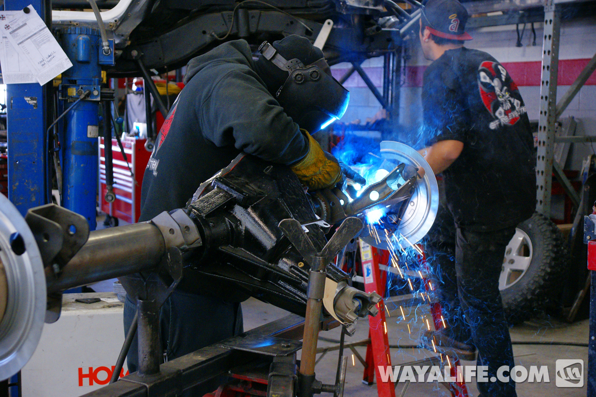

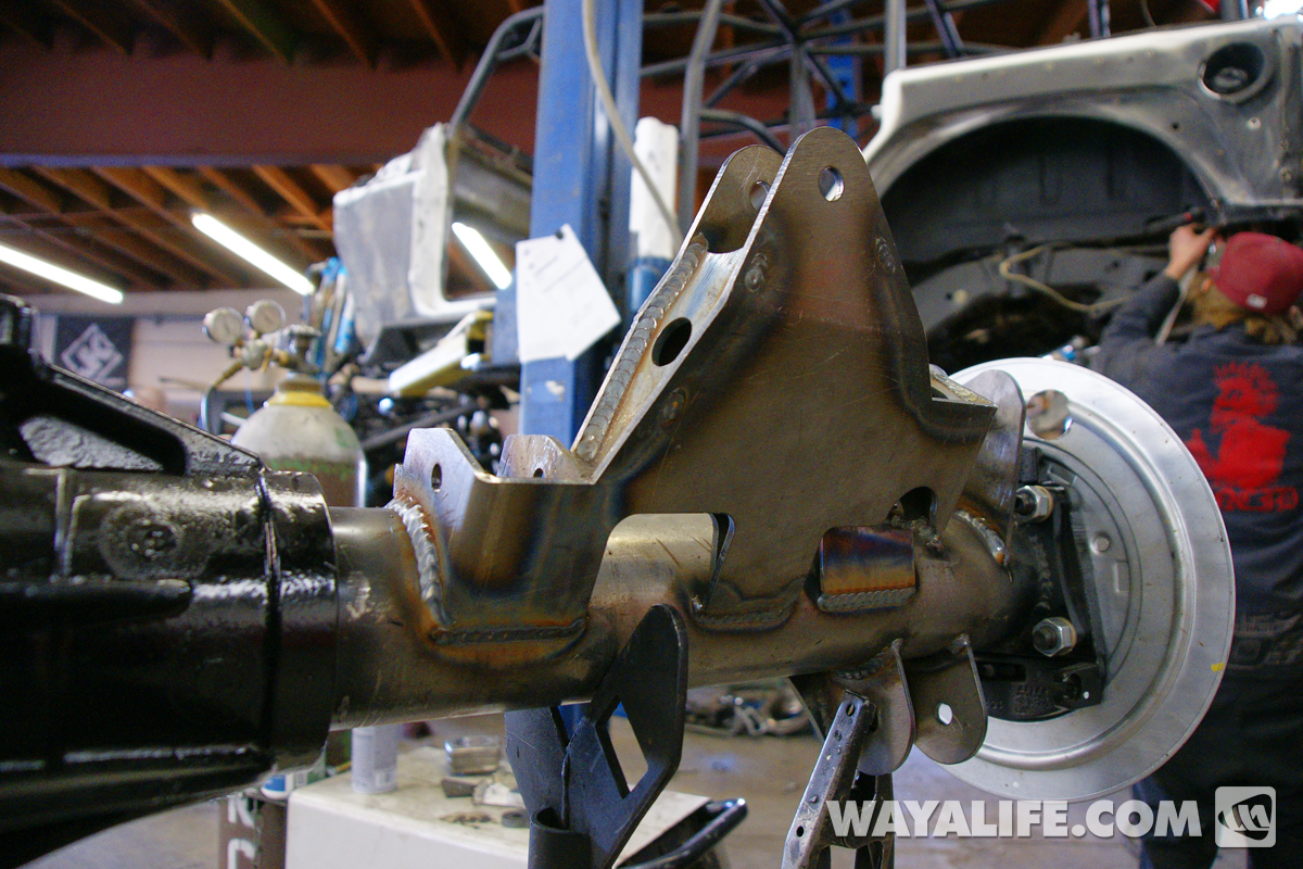

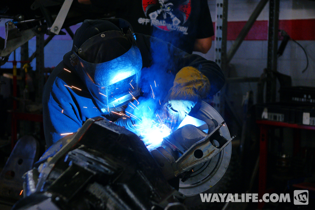

Welding the brackets onto the new Dynatrac ProRock 80...

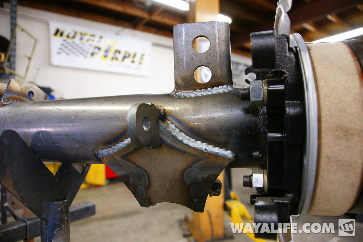

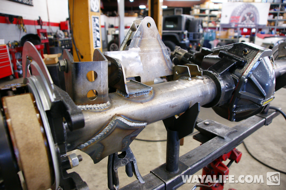

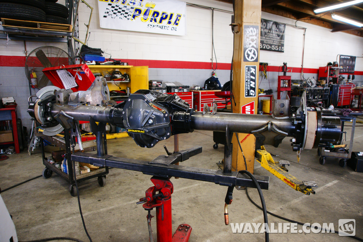

Dynatrac ProRock 80 rear all welded up for the EVO Lever and ready to install on EVO 1. Nice welds!
GCM 2
I've only ever seen one other 80 in all my searches. And that was an F150 that EVO did last year.
Mopar's Blue Crush has possibly the first one from Dynatrac that made it to public viewing about two years ago at SEMA. Sorry no rear drivetrain shots. But I'm sure if you searched the thousands of pics in Project JK's gallery they have from previous SEMA shows there might be one in there.

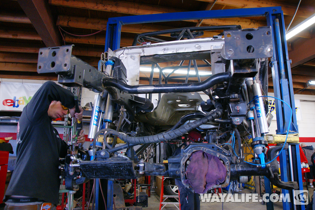

Hey Greg, what's with that tie rod in the picture? It looks like its 3+ pieces and has a shock in the middle...?
GCM 2
That is a "full hydraulic" ram setup. The traditional steering linkage only exist from the steering wheel to an orbital valve box which is usually mounted right near the fire wall or maybe near the engine block. There is no drag link, sector shaft, tie rods, steering gear box, etc. Hydraulic fluid basically steers the vehicle. Great for Offroad only race vehicles, not so good for street driven vehicles, very "touchy" steering.

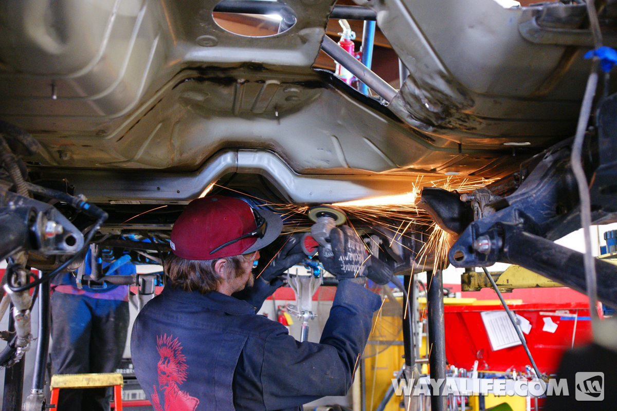

Cutting 7 inches off the front frame

New front end
