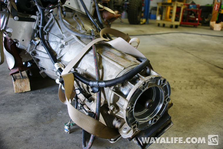

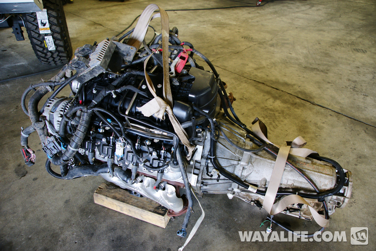

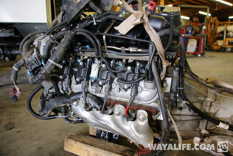

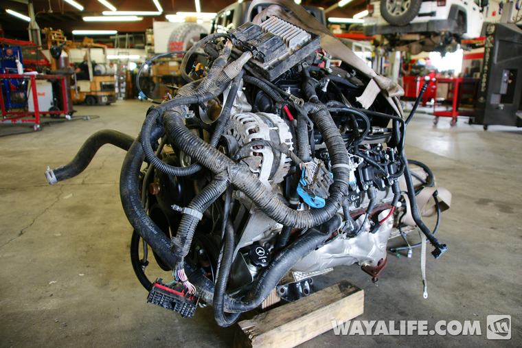

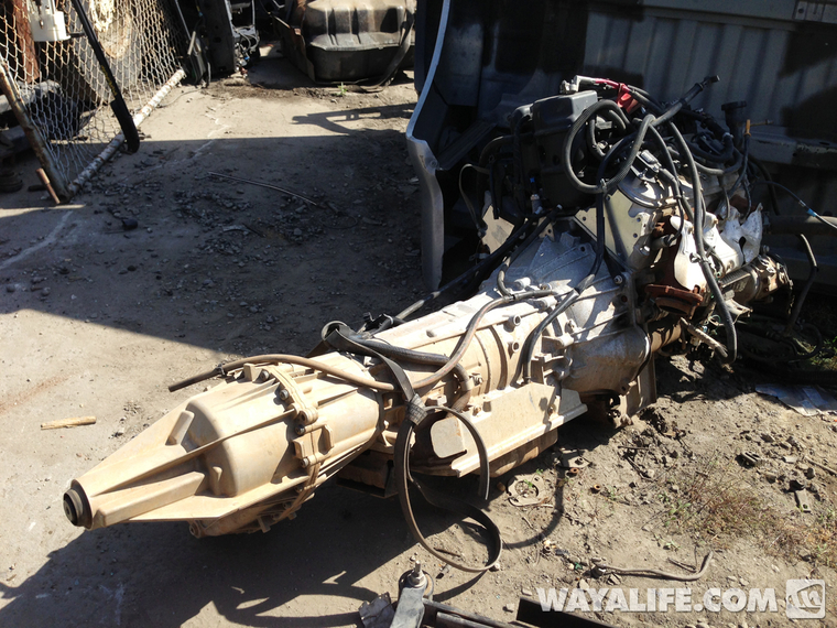

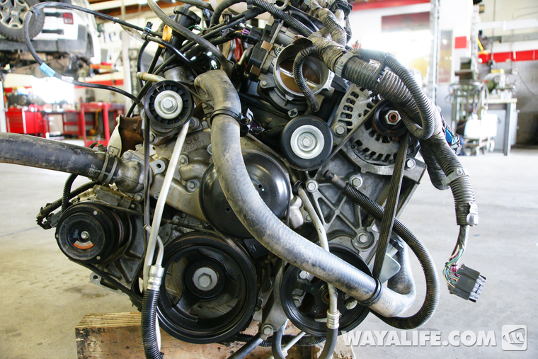

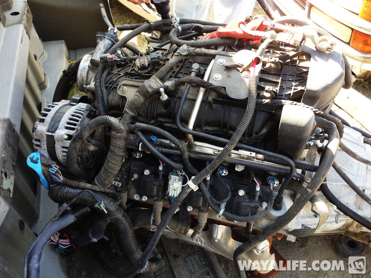

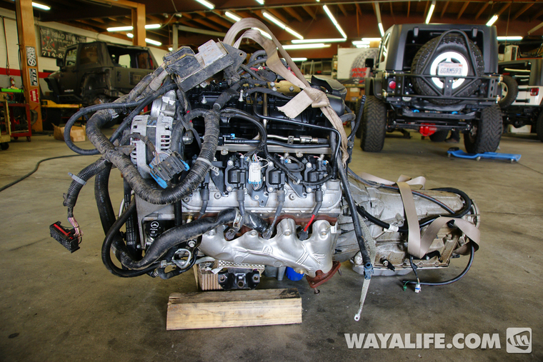

First on our list was to find a used LS engine/transmission from a 2007+ Silverado, Yukon or Escalade. From what we were told, it would also have to be from a truck/SUV that was a 4WD. After doing some searching, we finally found what we were looking for, a 2011 Yukon Denali 4WD 6.2L motor and transmission and if you can believe it, it only had 12,000 miles on it! Here are a few pics of it at the junkyard we found it at:
After checking it out, we agreed it was too good to pass up and so, we went ahead and bought it.As you can see, it is now sitting at Off Road Evolution with Moby just waiting for more parts to show up!
