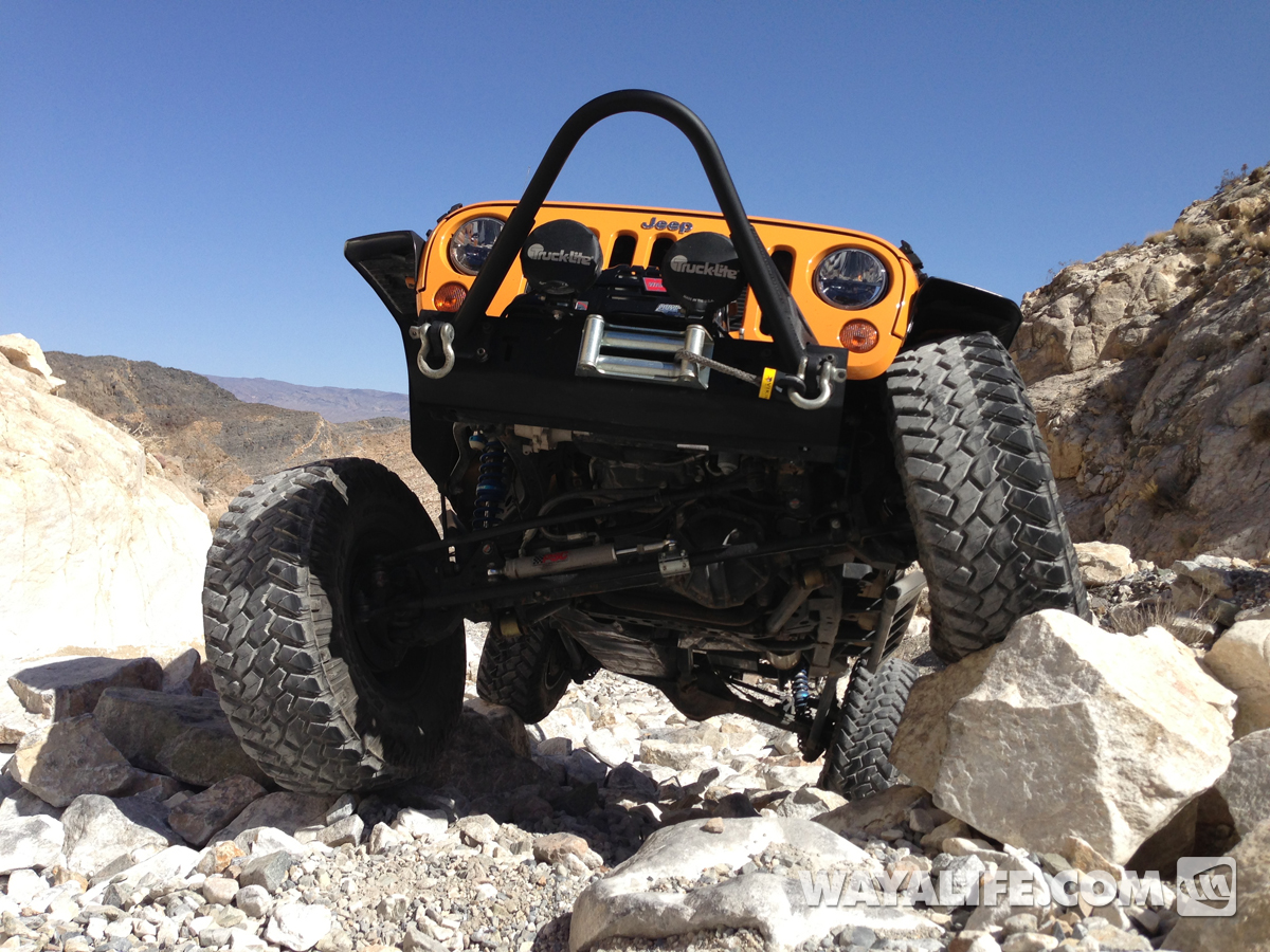

Not exactly. Shock travel doesn't always = true vertical travel. On the JK I posted up, it's only running 12" coil overs up front and 8" in the rear. The design of my suspension system allows for a true 14" of vertical travel. With that said, a Rebel kit with 14" coilovers only get about 9" of true vertical travel.
I get it lets all bash the guy with something different. Cool, no issues there. I probably deserve it.
Funny, I don't recall "bashing" you or anyone.
But all things being equal. 4" of lift and normal everyday shocks and 37" tires he has about the same flex I have and his arms hang closer to the ground.
Here's a shot of my other JK back when it was running bolt on coilovers set at 3" of lift and 37" tires on long arms.
I'm sure it's just me but I don't recall my long arms ever limiting my ground clearance or flex. :idontknow:
