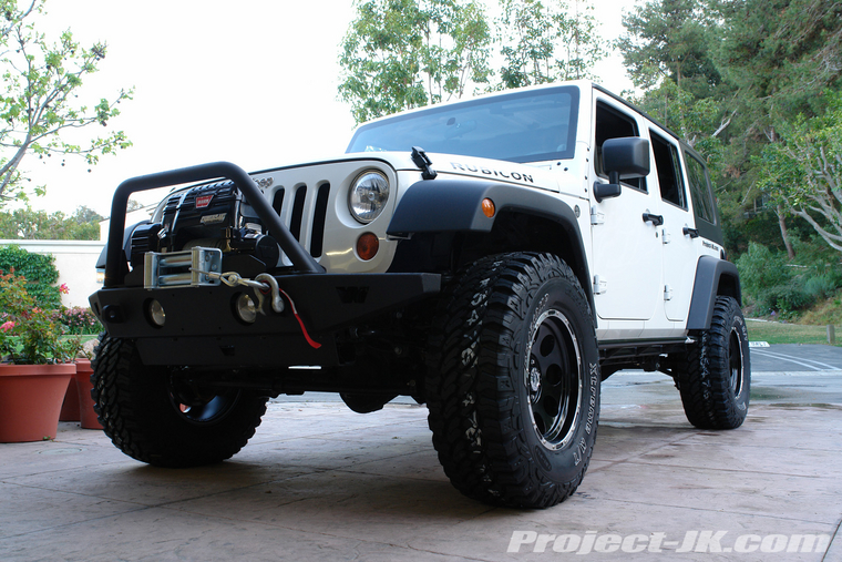

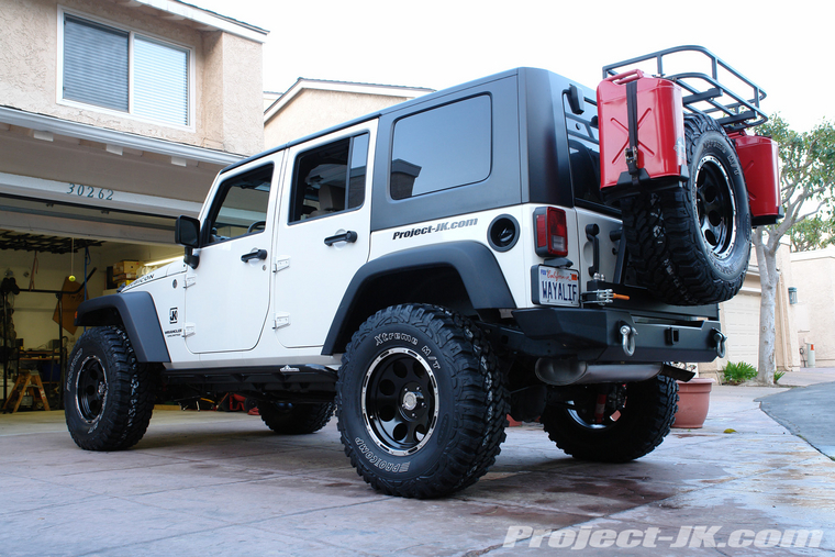

Not with a body lift but, here are a couple of shots of what our Jeep looked like running 35's on a 2.5" BB...
We have a manual so we never had any issues with the front DS. Being that you have a 12, you would need to run shock extenders or new shocks short enough to prevent DS damage. The body lift will give you more clearance between the tire and fender without having to effect anything else.
jkrossi
Only at a full flex and just a bit. I did have some minor rubbing at the rear pinch seam as well but cutting of the corner of it fixed that.
