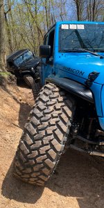

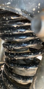

So after today’s run some issues I found. My bumps are just outright missing the pads at full stuff off camber and the bolt to my track bar is into my diff cover.

Which diff cover?
I posted all of them on the Rausch trip page. It’s the front cover. Just the pinch bolt is just hitting. Not a big deal but annoying.

Yeah. Get the control arms and track bars adjusted right. I mean if it’s an excuse to get coil overs by all means use it but you’ll still have to adjust them right.
Yeah. They are all adjusted right. Just had it aligned at the shop. Not really sure what I could different.
You can get correct alignment #s and still not have lengths set right. They shouldn’t be missing the bump stops. If the axle is coming up in front of bump stops control arms are too long. If the axle is coming up behind bump stops control arms are too short. If the axles is coming up left or right of bumps track bar length is wrong. Track bar position on axle bracket comes in to play also as the arch of track bar travel can move left or right when articulated. The trick is to cycle suspension w/out springs to see where it is. Adjust lengths at full compression while keeping them equal and then adjust for caster at ride height. I hope that makes sense.
Looking at the bump stop picture you’re not too far off. If I’m seeing the picture correctly the arms are a little long. 3/4” could make all the difference. If your arms are adjustable on vehicle it won’t be that hard to correct. You won’t even need a jack. Just a tape measure an angle finder (phone app works) and appropriate wrenches.
