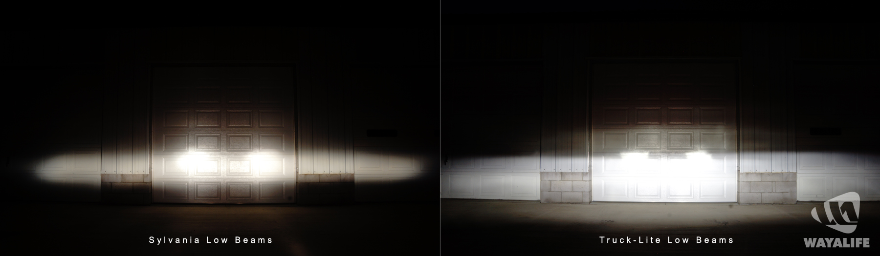

Before upgrading to Truck-Lite LED Headlights, I had been running Sylvania headlights and I should say that they provided much better lighting over the factory headlights but, they simply cannot compare to what the Truck-Lites put out. Below are side by side comparison shots of the two and you can decide for yourself just how much better the Truck-Lites are. Please note, all the photos were taken on a tripod and with the exact same ISO and F-stop settings.
Here's a low beam pattern comparison shot of the Sylvania and the Truck-Lites up shining up against a garage door.
Now, here's a high beam pattern comparison shot up against the same garage door. As you will see, the Sylvanias simply project the light beam higher whereas the Truck-Lite's retain the low beams while ADDING the high beams. This provides a much brighter and fuller pattern.

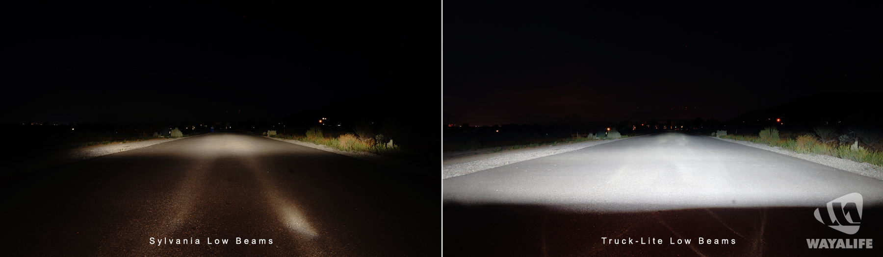

Here's a low beam test with the headlights shining down a dark street. Notice how much whiter, brighter and fuller the Truck-Lite LED headlights are by comparison to the Sylvania's.
Now, here's the same test only with the high beams. Because the Sylvania's only project their lights higher, everything immediately in front of you is illuminated a lot less. Of course, being that the Truck-Lite ADD a higher beam in addition to the low beams, you can still see very well immediately in front of you as well as way out in front of you.
