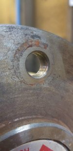

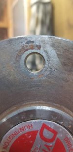

Pull the old one out and check a new stud in the hole before you start getting too worried. Axle shafts are generally made of harder steel than wheel studs and take quite a bit to deform. Unless you had this free spinning with an impact making a bunch heat in there the axle is probably fine.
desertrunner

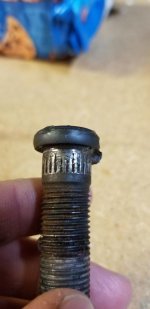

So we tacked the stud got the lug nut off and pressed out the stud. The splines on the stud are obviously stripped, the hole on the axle shaft looks un damaged. Dynatrac is sending me a new stud looks like I'll be good to go.
