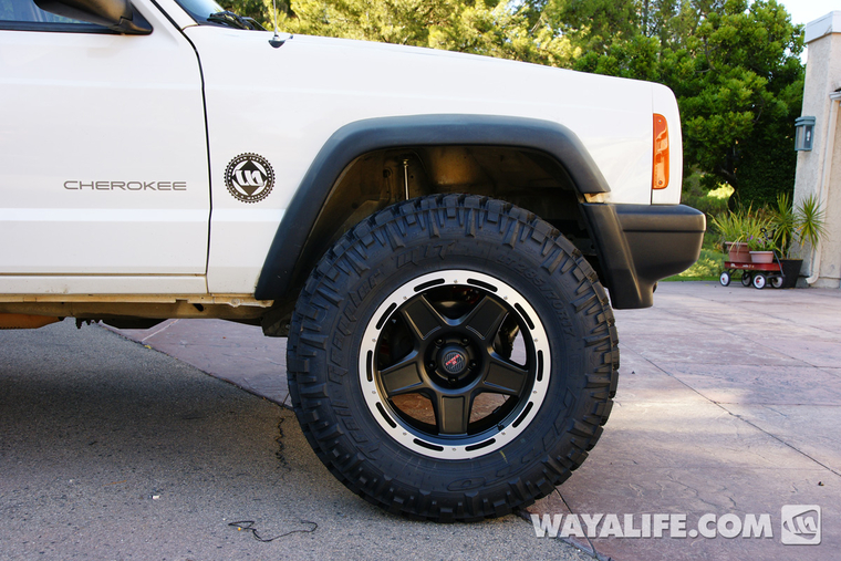

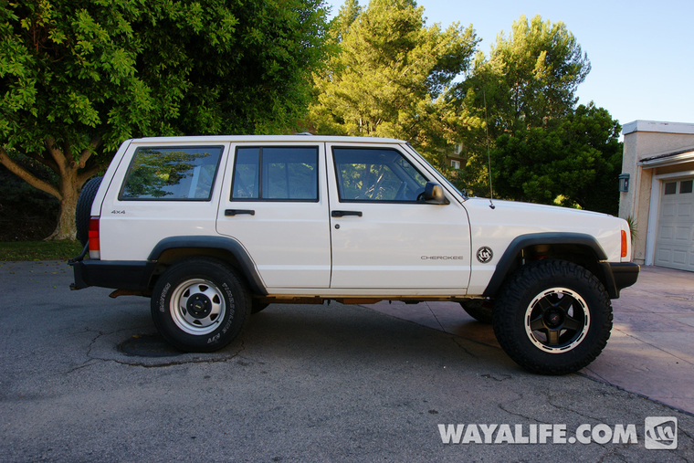

Okay, the front end is done and here's a shot of what it looks like with the new 33" Nitto Trail Grapplers installed. Yes, the fender will need to go and we will have to do some trimming but, I think this shot give you an idea of just how much bigger our XJ will be compared to stock...
Here's a close up shot of the front end...
Just need to remove the bumper end caps and get our new Bushwacker flat fenders in - waiting patiently for them :crazyeyes:
