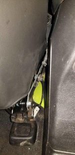

Got the drivers side all finished up. Everything is bolted down and fits nicely. The buckle extension worked out and got all nylock nuts installed with it and I still have full range of the slide with easy access to the buckle. I rounded off the corners of the bracket and gave it a little paint. 20191103_155509.jpg
Ran into my first snag on the passenger side. So the stock slider mount on the passenger side has some lateral bar support that was not on the drivers side. The PRP mount is supposed to sit flush to the slider and that lateral bar is in the way. Even worse that bar is not bolted it's riveted to the slider so I gotta figure out how the hell I'm gonna get that off....
Pics for reference first is driver side second is passenger side.20191031_133724.jpg20191103_163613.jpg

So I was able to cut the heads off of those rivets and pull that bar off pretty easy. That bar was only there to allow the slide to move freely when the seat is folded forward so really no impact to me now.
