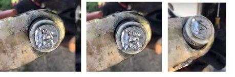

I posted a little bit ago, mybadjk just had one of those G2 axles fail on him and from the look of the picture, the stub shaft looked really wollowed out like the ujoint wasn't sitting in it properly. Granted it may have been a one time occurrence, I wouldn't feel so comfy with them. It also took him a long time to get a replacement stub shaft.
This ^^^^
After seeing mybadjk's failure and the way they've been "helping" him out, there's no way I'd want to run G2's.

Well that's odd and unfortunate, not sure how often that happens or not. Is there a thread with photos of the break?

Not sure why it would be odd but it is unfortunate the way G2 isn't taking care of him.....

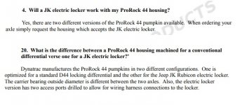

The casting is machined differently to accept the TruLock. The casing on the standard 35 spline is too big because of the thick JK gears. Therefore you use one meant for a higher gear ratio which means the casing is smaller for a Rubicon 44. The non-rubicon 44 is machined to a standard Dana 44 size. That accepts thick gears and the larger differential casing.

2 different housings:
https://www.dynatrac.com/downloads/ProRock FAQ_revK.pdf
Excellent description, thank you!
