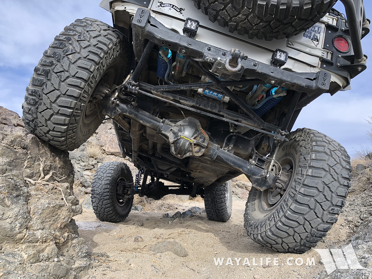

Yup. Factory e-disco died a while back so now we're running an EVO No-Limits knob on it. In the rear, we're running a factory rear sway bar as you can see here.
On Rubicat too. In fact, this is a better photo as you can see our limiting strap is taught.

Just looked up some videos on that, Very nice, I believe my mind is been changed. Like your hitch to, Handy and removeable.

Just can’t argue with success (and if those pics don’t convince someone this works...)

Good Lord, lol looks like your front fell off. That's awesome! I've seen some shit here and there, but that's cool as hell. I'll say that sell it. [emoji106]

In Eddie's pic above that's also with 14" coliovers so that's very impressive.
