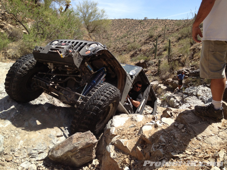

thos are 2 very well stated reasons and couldn't agree more. i thought it was especially telling how both you and mel were able to take on the big, near vertical waterfall on axle alley without loosing your transmission while dave (no RK deep sump pan) was not able to.

Eddie, unfortunately sometimes we learn the hard way (or at least I do occasionally). Just trying to pass on valid facts my man :beer:
Edit: and btw, I keep forgetting the couple that heard our JK's in the canyon and showed up on the razor atv to check it out (the guy in blue just visible behind my JK) and how they laughed at us sizing up the obstacle......until we all drove up and over that waterfall!
