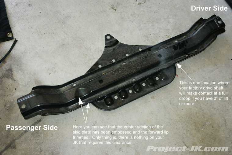

The problem with the automatic skid plate has nothing to do with brush. It's a design error that made it all the way to manufacturing. :crazyeyes:
I had trouble with mine after my first lift was installed. With the extra droop I was getting, the front driveshaft would hit the skid plate. After some grinding I was able to fix the problem. There was also a recall from Chrysler to change out the skid to a new design, due to plants getting trapped near the cat.

The holes and notches are not the problem but, the error in design is physically manufactured into the skid and it's very easy to see if you know what you're looking at. :crazyeyes:

The issue I am referring to is a "design error", not a "problem". It's something that would have been a beneficial feature. :crazyeyes:

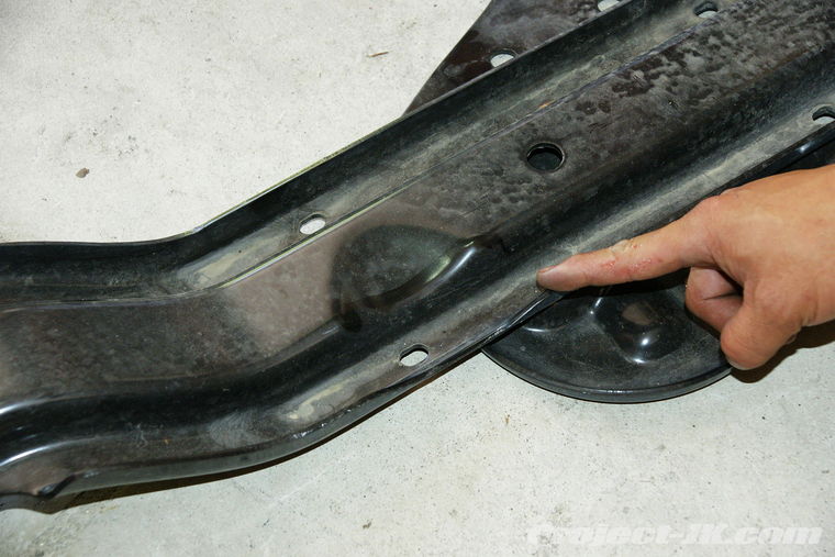

Unfortunately, I don't think this is something you could guess - you'd have to look at the skid to see the error. I do have a photo of this but that would give it away.
Could they have machined a saddle or valley in it where the driveshaft wouldn't hit it at all? Just guessing here. Now I'm curious.
Hot damn, you got it!! Or at least, close enough. As you can see in the photo below, Jeep did in fact design into the skid plate an embossed valley and even a trimmed the front lip to help accommodate the droop of a front drive shaft. Only problem is, THEY PUT IT ON THE WRONG SIDE! Instead of placing this feature on the driver side where the drive shaft is, they put it on the passenger side where nothing is. :crazyeyes:
