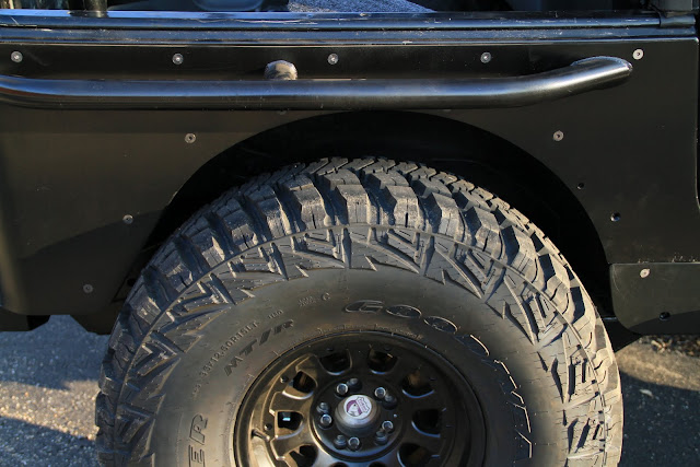

Installed my rockers and tossed in the bedrug carpet I got in last week. Which seems to fit quite well, I'll have a little trimming to do but nothing to crazy. Not bad for just over $150.

So I took a few flexing shots and poser shots.
For the flex shots I left the front sway bar connected which didn't really allow for a huge amount of flex. I'm going to remove them at some point and recheck
I also think I need to remove a little bumpstop to allow for more travel I still have plenty of room on my shock to use up (about 5 inches) but I really have to fully cycle my suspension a bunch before I start pulling it out I guess. I took a lot of time measuring before everything went in so I don't want to waste time if its keeping everything safe right now.
